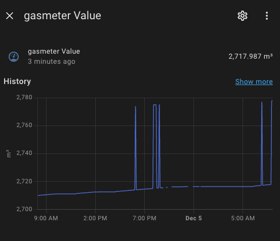

My AI on the edge for gas meter is confusing numbers sometimes and is producing wrong data (see image)
Is there a world where we can edit from UI historical data and it propagates across other statistics?
Would also appreciate tips and tricks into how to fix this in my case
And yes, I understand that I need to fix my source of data but IMHO this needs a way to fix from HA because one such bad reading and your averages, statistics and other potential metrics are skewed and you can’t really do anything about it
For more clarity:
I am using a esp32 cam with this GitHub - jomjol/AI-on-the-edge-device: Easy to use device for connecting "old" measuring units (water, power, gas, ...) to the digital world and pushing the data via MQTT integration with discovery.
Every 5 minutes there’s a reading where it takes a photo, and tries to parse analog gas meter numbers into digits. In the process of converting image to numbers it wrongly might detect 3 as 9 or 2 as 7 and so on

Thanks for the reply, I updated the post to clarify the setup and sensor data acquisition. I am yet to play with the filter, but it seems that it should do the job. Do you know if this can be configured somehow from UI or is it a config.yaml only way?
In the meantime you can use a a filter entity to smooth or discard the broken data. See Filter - Home Assistant. With the way your data spikes and reverts it looks like there would be several options for the specific filter, outlier would be my starting point but low-pass may also work well.
Edit: Haha I see someone else had the same thought while I was typing!
It’s a yaml-only sensor unfortunately, and requires a restart to pick up the first one. Once you have it created, you can reload just the filter entities from the Developer page.
