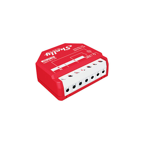

Holy sā¦t how much Wave costsā¦
I meant the Shelly 1PM Gen4 that costs half of that.

i cant get it for 23 euro.
i provided link to 1pm gen4, what costs half of that?
i need to know what can be used/ how ⦠wont be do that physicaly.

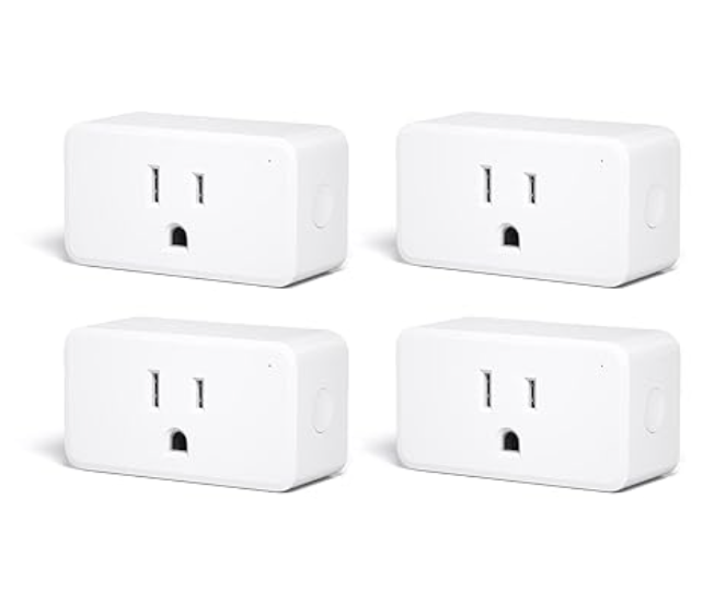

Or use something like that
You linked Wave.

@Zenia using simillar but want to have clean design.
you mean zigbee/? got lost.

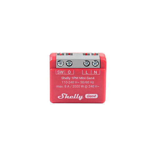

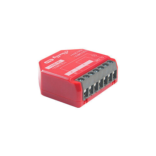

this is 8A and they installed it into the wall socket?
There are several 1PMās with different specs on the site.
āTheyā should not.

Zigbee , WIFI or what ever you prefer. I mean one which you can plug in to the outlet without intervened
