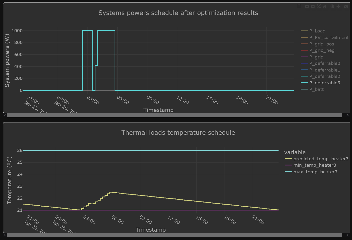

For some reason the thermal model parsing treatment logic has always been inside a if set_type == "naive-mpc-optim" condition.
There is absolutely no reason for this.
I’m currently applying a patch to fix this: Fix the thermal load parsing to use it on any type of optimization by davidusb-geek · Pull Request #678 · davidusb-geek/emhass · GitHub
UPDATE: Should be fixed in new patched version v0.15.5

Hello! I’m trying to implement the new thermal_battery model for my house with underfloor heating and a heat pump. Figuring out the parameters I need was a bit difficult, but I think I have a good base line to tune once I start using it.
However, there are two things that I can’t really get working. Both have to do with heat pumps preferring longer runs instead of multiple shorter runs.
The first thing is that I can’t get the startup penalty working. For example, I just tested my configuration and I got this forecast:
The run from 2:30 to 5:30 is a great choice considering the prices, but the stop in the middle at 3:30 does not make sense. 3:30 is the most expensive period, but the price difference to the second most expensive period is 0,001 euro. I have configured a startup penalty for this load, which probably would’ve fixed this run, but it seems that that just gets ignored. Is that a bug or by design? If by design, is there any alternative for getting longer runs?
The other thing is that I can’t set the nominal power of my heat pump to the true value. If I set it too high, EMHASS will give me multiple super short runs, instead of one long run. Even though it still has a lot of room before hitting the max temperatures. I have settled on 1000W for now, which gives me reasonable schedules, even though my heat pump can actually ramp up to 2500W if necessary. Is there any way I could fix this?
This behaviour might be fixed by using startup penalties, but from my example above, I think that doesn’t work with thermal_battery.
Is there someone that has a working thermal_battery configuration with reasonable schedules? Are there any tips you could give me for getting this to work?
These are my thermal_battery parameters (thermal_battery config at the bottom):

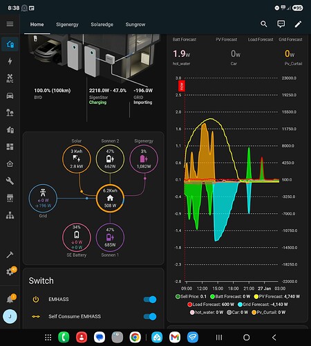

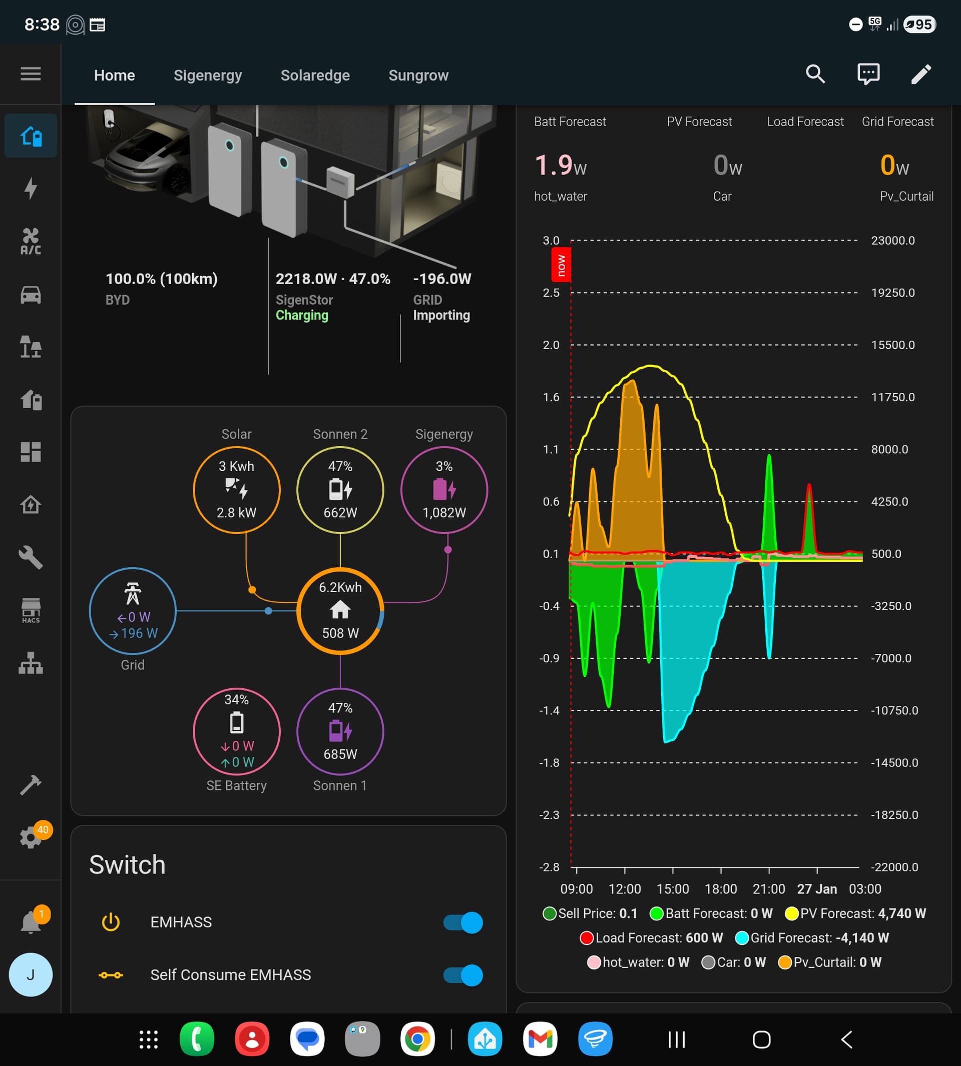

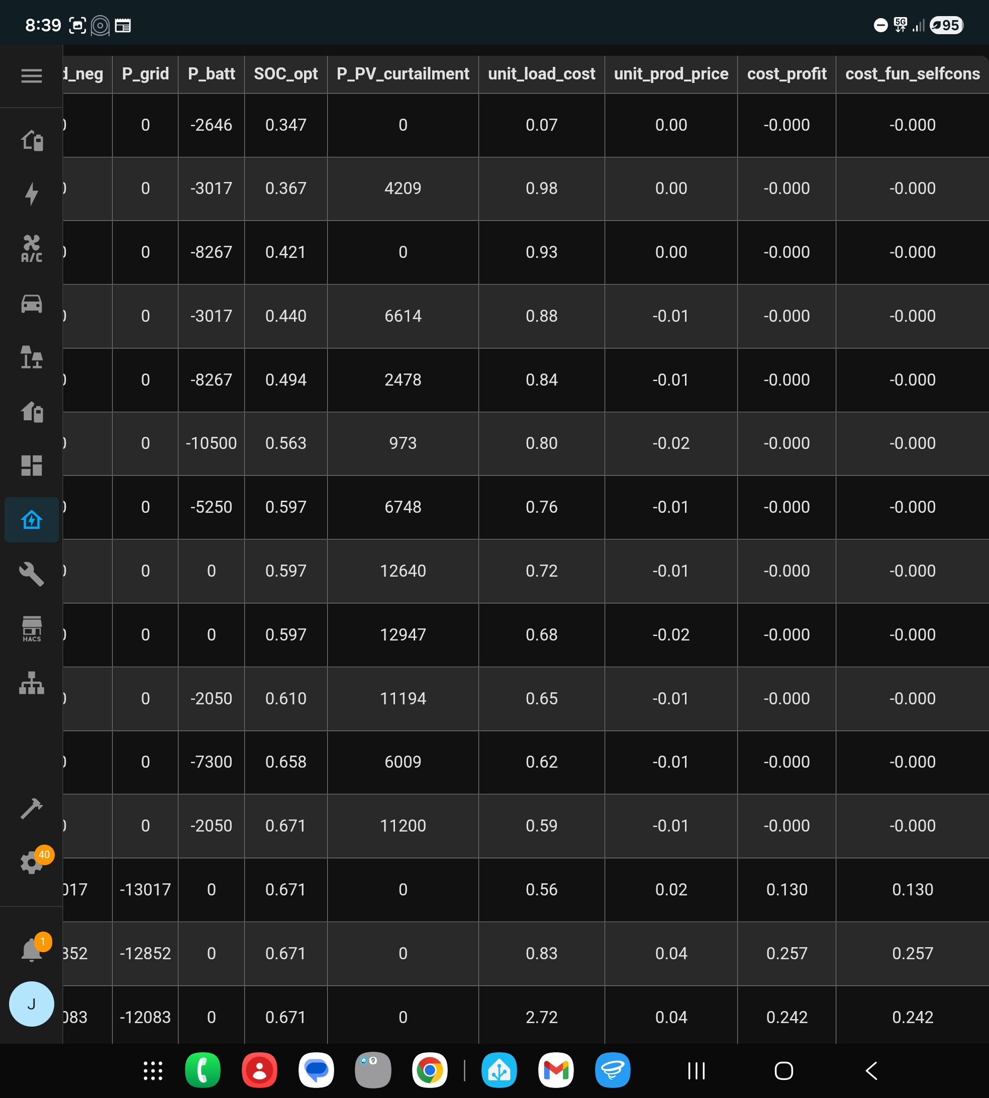

Hi All
Why does the pv curtailing happen when the rates are negative then charge when rates are ok.
This is so odd that the system would consider charging when it could be discharging.
Would this be a setting?
