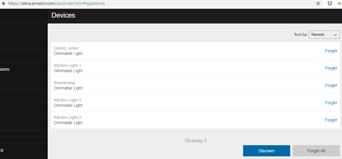

Just an FYI for everyone who contributed to this discussion. Today I reset my edgerouter x to it’s factory defaults and everything worked just fine. No idea how or why.
I did not enable UPNP on edgerouter x, nor did I put alexa: in my configuration.yaml. I didn’t even tell alexa to scan for specifically gen1 of the hue bridge. I just clicked the Discover button in alexa. Basically, this is the whole thing.
configuration.yaml
emulated_hue: !include emulated_hue.yaml
emulated_hue.yaml
host_ip: 192.168.1.35
listen_port: 8300
off_maps_to_on_domains:
 - script
 - scene
expose_by_default: false
exposed_domains:
 - light
 - script
entities:
 script.boomeranghd:
  hidden: false
 script.disneyjunior:
  hidden: false
 light.kitchen_light_1:
  name: "Kitchen Light 1"
  hidden: false
 light.kitchen_light_2:
  name: "Kitchen Light 2"
  hidden: false
 light.kitchen_light_3:
  name: "Kitchen Light 3"
  hidden: false
I haven’t created any routines yet, cause the kids are watching TV right now, but since alexa can see the entities in Home Assistant, I can only assume it will work.
Thanks everyone for your help, greatly appreciated!
