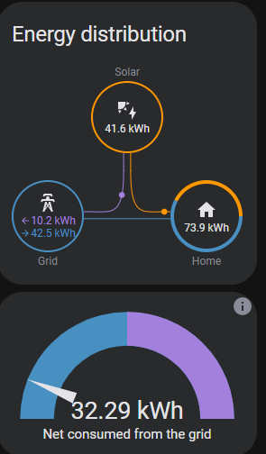

Energy consumed Grid Calculation Setting
I mentioned it a year ago, but now I’m making a feature request.
In Germany, the EVU doesn’t care whether I return electricity from my balcony solar power system - so the total “net consumption from the grid” in HA is completely wrong.
HA subtracts “Return to Grid” from “Consumed from Grid” - that doesn’t make sense - or HA has to give us settings that let us choose what behavior we want.
I hope I describe the problem as best as I can and you know what I mean.

Well - since Aug. 2024 no answers - is this such a big thing to integrate a setting for this Dashboard or Calculation ?
The Netto Import doesnt make sense in Germany - or i think in many other Countrys…
if i use 2kw and push 1kw in the grid, i dont buy 1kw - i buy 2kw… the 1kw is surplus power of the PV system
