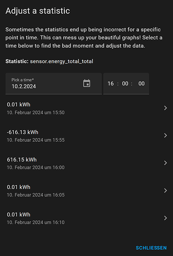

Today it happened to me too… energy dashboard screwed due to sensor fault in “grid usage” input sensor.
I accidentally noticed this:
I can’t have negative values. Only taking power from the grid currently.

Reason is, that a part of all input sensors was not available. Due to my calculation template above, the sum is calculated without those. Unfortunately that happened quite often as history shows…
…but luckily it never happened right at the snapshot time when LTS is being generated. This was the case today for the 1st time (part of the input sensors like sensor.energy_2_total were unavailable) right from 15:59:14 until 16:00:07, so that the LTS generation at 16:00:00 catched the dropped value and… et voila, the energy dashboard is screwed.
Todays’ drop/incident is exactly 616,13 kWh.

As to fixing the negative value:You found the screen to fix it, just click on ithe -616.13 value and set the value to 0. But you should then also do it to the corresponding +616.15 value (which you should set to 0.02 to be exact).
But you don’t have to, as they cancel each other out. value. The statistics saw it disappear and reappear. So you might also decide to leave it as is, as netto there isn’t a problem, only if you look closely in time.

  1. This will fix tables statistics and statistics_short_term, but not states, right? Latter one might be interesting for graphs, at least until the recorder retention time is reached and they are removed from the database anyway. So: using the dev-tools statistics section is sufficient for fixing the energy dashboard?
  1. Are you sure about this? I expect the energy dashboard to continue the negative value for week, month and year. For week once today has passed (and so on). Won’t it?

No, but that problem is indeed gone once the retention period (default 10 days) is over.
You will see it within day level, but on daytotal and larger periods, it cancels out. But edit them both if you want it clean. Just realise the plus version is also wrong. You noticed the same behaviour when it happens within the hour: if is canceled (but it was registered in statistics). It is only because it happened around the hour that you can see it.
