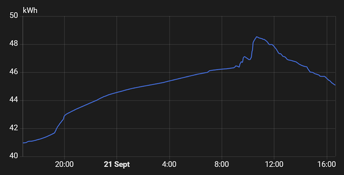

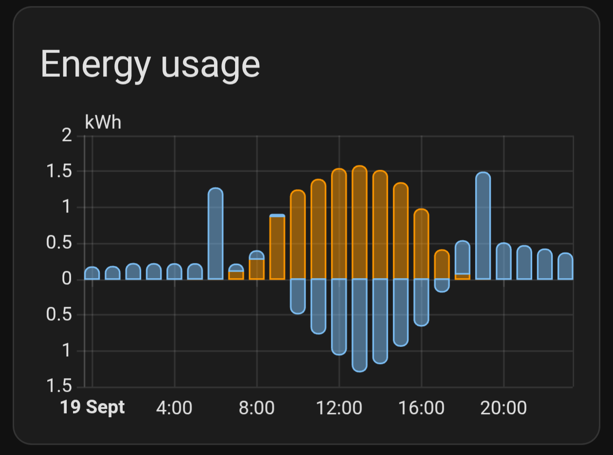

The main power goes ± on import and export, so the total kWh goes up and down depending on direction. So the display never show exported amount just “negative” consumption. Here is yesterday’s chart:
You can see rather than showing the purple export it just shows the lines still in the blue as export.

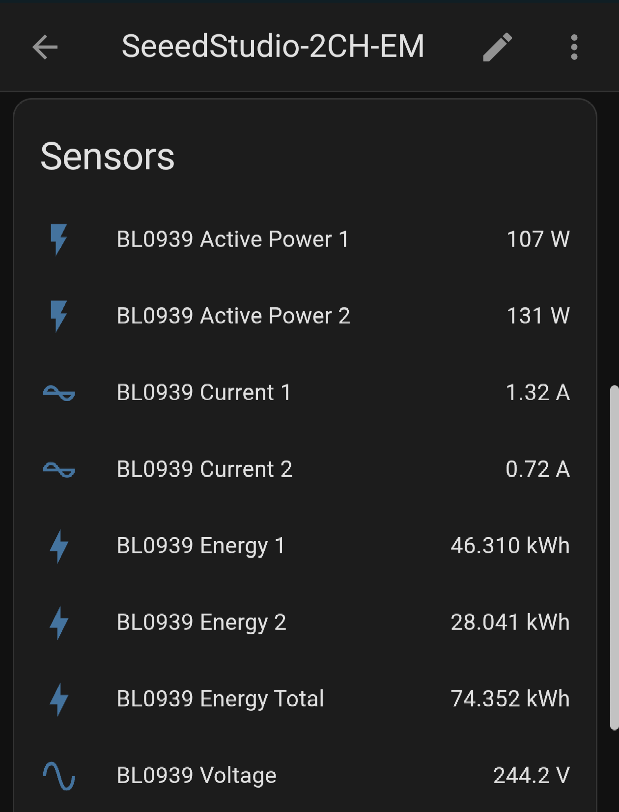

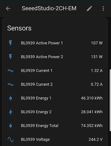

Here are the sensors from the sensor:
Not sure how to fix this, the only thing I can think of is to make a couple of helpers that do something like add up based on if power is going in or out but it feels like a brute force solution. So was hoping someone might have a more elegant method before I brute force it all!

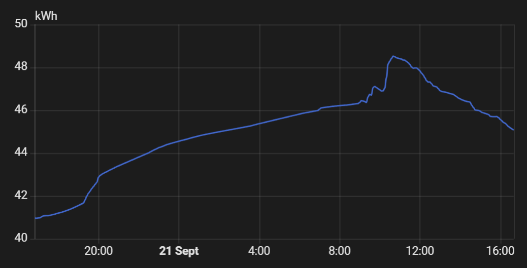

For example, here is the chart for today, you can see at about 10am when the clouds cleared and sun came out, the power was being exported so the total kWh consumed from the grid was going down:
I need to split this into two kWh, one adding the rises in kWh and another adding the reductions.
