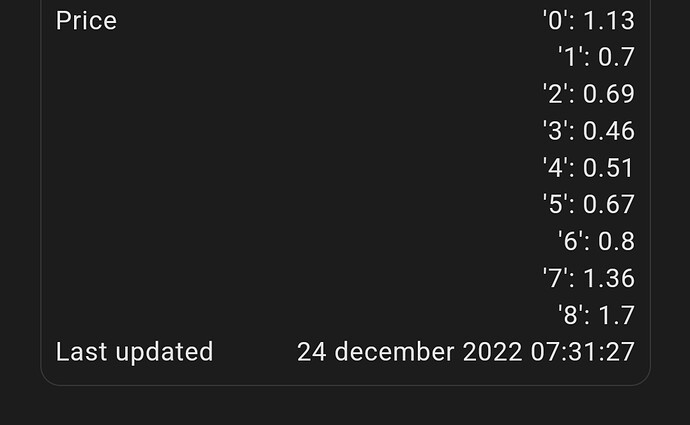

When I check the attributes of the score sensor it still only lists the hours passed.
Am I missing something again? :sweat_smile:
Can you please post a picture of energyscore sensor attributes and nordpool sensor attributes?

You need to be on version 0.3.0 or above for nordpool to give you more accuracy on energyscore. From your attributes it seems like you are not, please check HACS for update and reboot HA afterwards.

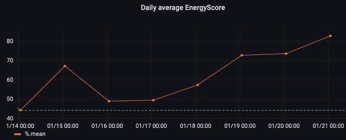

My intention with the EnergyScore is mainly to verify optimisation efforts to see what is working and what is not. Due to using a lot of time on developing the integration I have not explored too much on how to visualise this in a good way yet.
I did start some testing yesterday though, when I set up a new automation that blocks the immersion heater in my boiler in the most expensive hours of a given day. I think that trending the average energyscore before and after such an implementation will provide me with answer if its working as intended (and thus saving me money). Yesterday I got the highest average energyscore for the week at 83%.
I still need to experiment with this more, maybe minimum of the day is better than average? Another thing that is not captured in the EnergyScore now is that if an automation delays (or accelerates) energy usage and it results in cumulative more energy used it is not necessarily good… Still think it’s good to have a score to verify effect of optimisation!
Hi, I tested as well with a statistic graph and it turned out pretty ok. Averege, min and max per day over 30 days…
Awesome, did you do something to optimise your energy usage during the last 14 days period or is the increased score just statistical coincidence?
