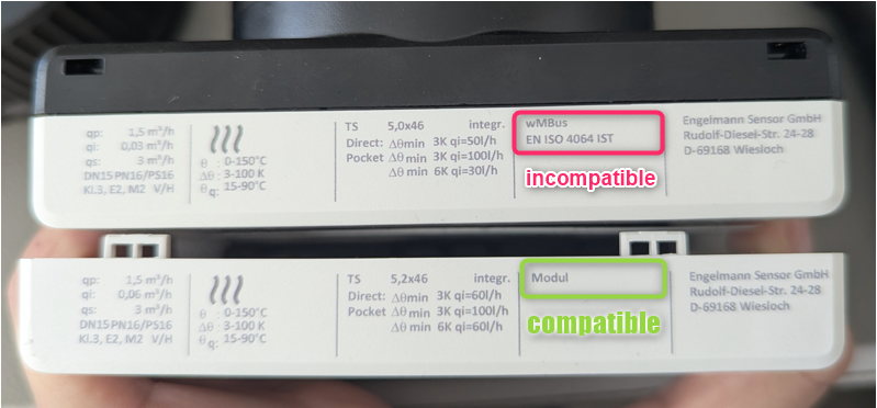

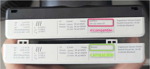

Checking if it’s compatible.
You can find the Sensostar U/E in several different versions in shops. The only versions that work are the ones with the “Modul” string on the top edge of the front cover.

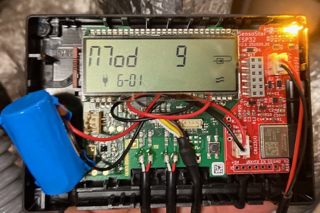

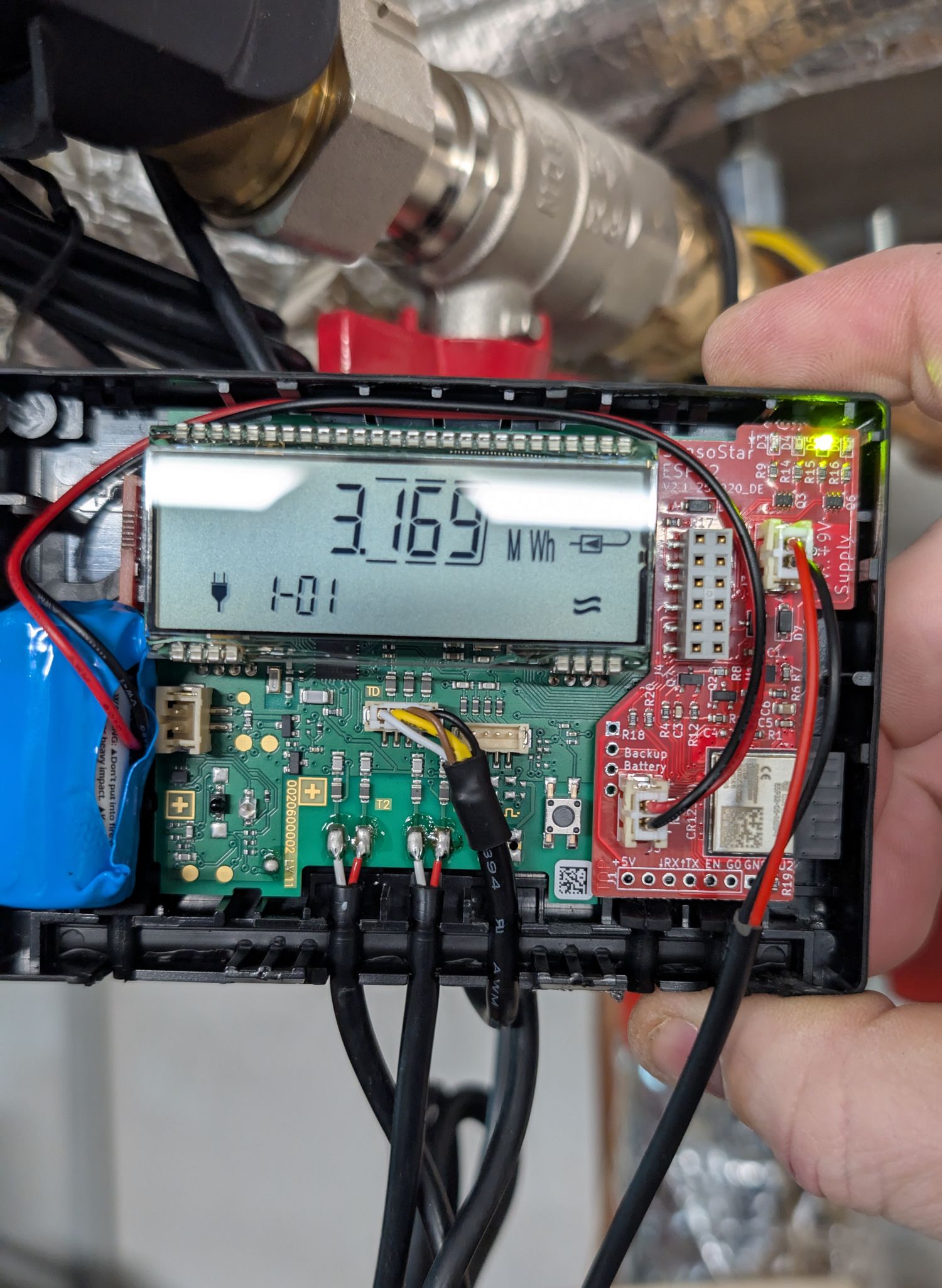

Hi Dirk,
I am happy to share that I have received my package (PCB, PowerDongle, Battery and USB-Cable) in good condition.
Have fitted it to my Sensostar yesterday and it is working like a charm.
Thank you very much for all your effort and your excellent work!!!
Ole

The PCB has arrived today and I installed it instantly.
It works like a charm!
Many Thanks to @STB3 for the good work.

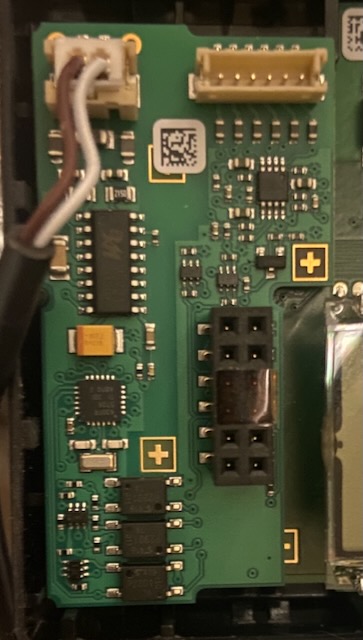

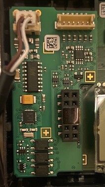

Hello Dirk,

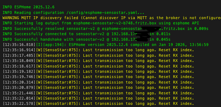

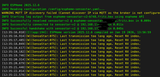

I converted the Sensostar today. The ESP does not seem to be receiving any communication. I previously had the MBUS module and everything was fine. Do you have any ideas? I am using sensostart_red.yaml in ESPHOME.
Michael
Yes, it looks like there is no data coming from the heat meter as is.
Did you flash modifications to the board or is it the stock firmware it came with?
Could you post a picture of the MBUS module? I’d like to compare it with mine to see if there are any differences.
Is the red LED blinking?
Regards,
Dirk

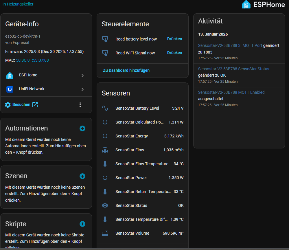

Hi Dirk,
No, it’s not the firmware you played. I compiled it with the following yaml using esphome 2025.12.6. The red LED is not flashing.
