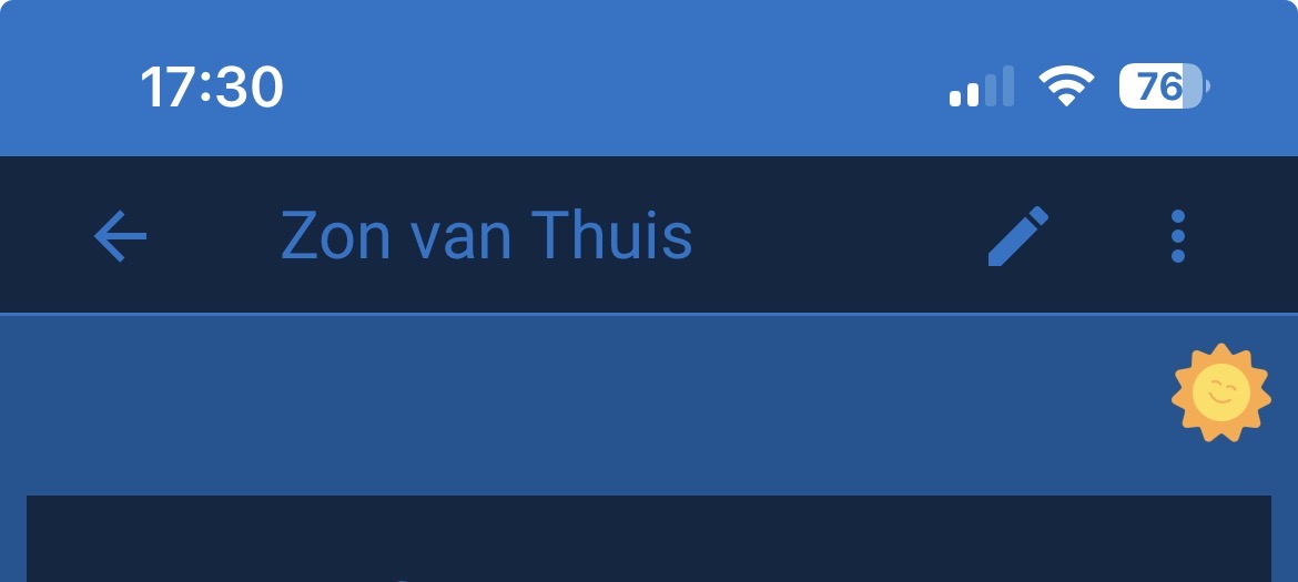

The “of Home” suffix is a Dutch thing. And actually, it’s not a suffix that is added, but rather a prefix. I.e., “Zon van” is the prefix added to the configuration entry’s name of “Thuis”. In English, it would be a suffix of “Sun” added to the name, e.g., “Home Sun”.
BTW, it was changed from “CFG_NAME Zon” to “Zon van CFG_NAME” in the 3.1.0 release. The change was submitted by a couple of people who reviewed nl.json as it existed at that time.
In any case, the way it works is, you give the configuration entry a name, then the service it creates has the prefix/suffix automatically attached (via the appropriate language JSON file.) Then the names of the entities are the service name + an entity specific name. And, of course, the entity IDs are based on those entity names.
If you don’t like “Sun of Home” / “Zon van Thuis” for the name of the service, then just change it. That’s what the edit button (i.e., the pencil icon) is for. Then, if you want, you can recreate the entity IDs based on this new service name. To do so, you can click the three-dot button and select “Recreate entity IDs”, or you can do them one at a time via each entity’s “more info” dialog.

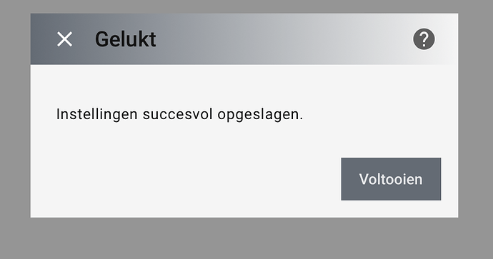

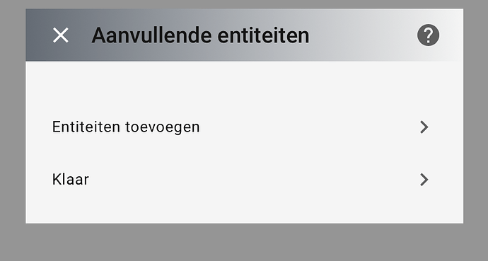

in the config flow for additional entities, we get a navigate > for individual sensor setup, and the same for ‘Ready’ (Klaar)
that Ready is a bit odd, and usually represented by an action button on the card itself? (Like in the following)

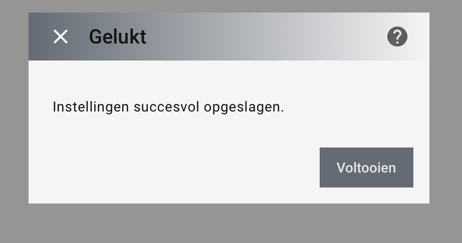

because clicking the Klaar results in
Successfully saved settings.
So, not really important, but feels a bit awkward, and superflous.
The Ready (Voltooien) could be on the first config flow card?
That page is a “menu”, not a “form”. Menus don’t have a button like forms do.

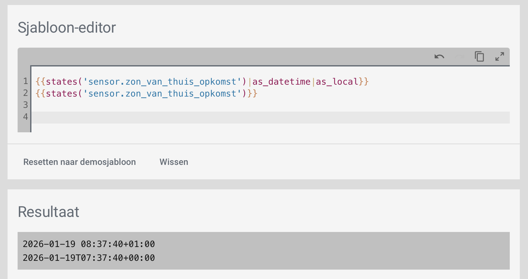

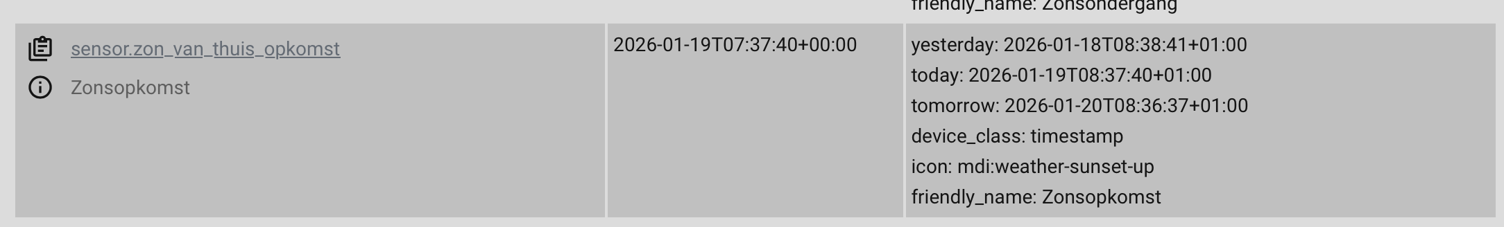

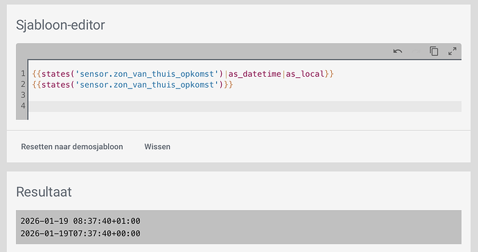

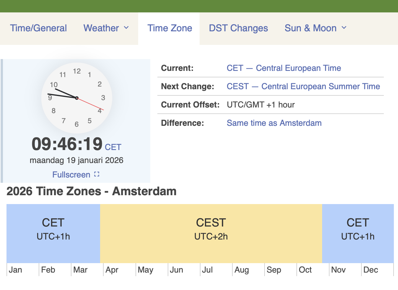

this might be very stupid, but why do we see a +1 for the attributes, while the state shows the time incorrectly? not offset that is. that is not the HA system re-formatting to local? Should those states be always recalculated to UTC?

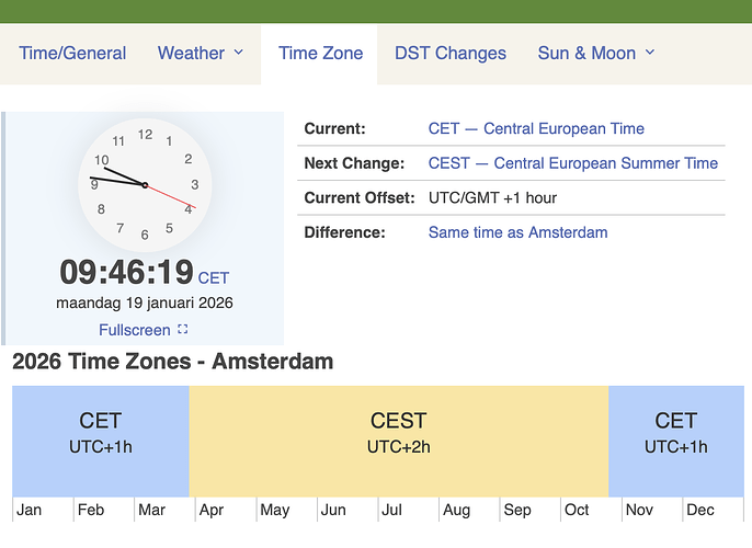

we’re in CET, so UTC +1, and no Dst active …
HA Core has been converting timestamp sensors to ISO formatted UTC for a long time:
The Sun2 integration provides the value in the timezone defined for the config, just like the attributes, but the Core code converts the state to an ISO formatted string in UTC.
my eyes just must have missed that all this time. What would be the reasoning behind not recalculating converting these attributes?
It’s not the attributes that are being converted. I chose to have the Sun2 integration represent all datetimes in the timezone of the config (i.e. integration entry.) It’s the main state that is being converted. Why the Core team chose to have all timestamp sensors shown in UTC I wouldn’t know.
