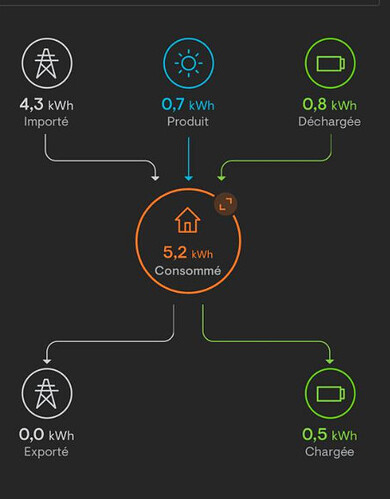

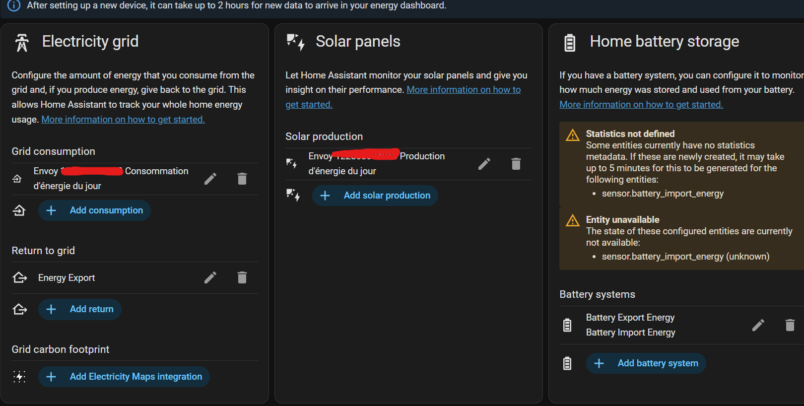

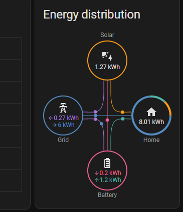

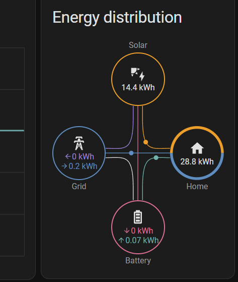

why it show me a flow from solar production in the night ?

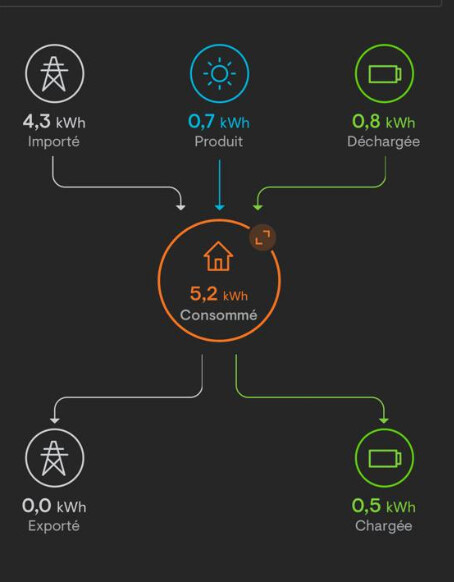

But what is strange is that thius picture show that my home conume 28,8 kwh , but on my Enphase app i have 12,2kwh home consume and 7,8kwh for battery charged… and 2,5kwh for export.
do you know why i have the big value of 28,8kwh ?

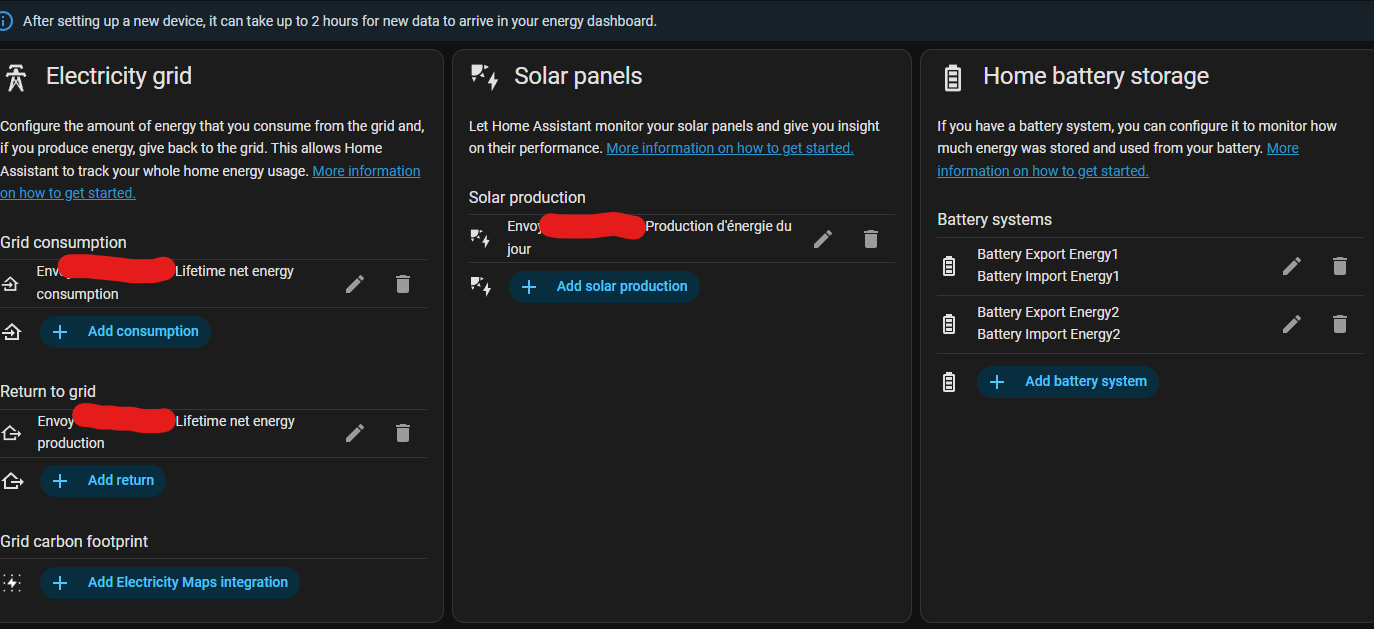

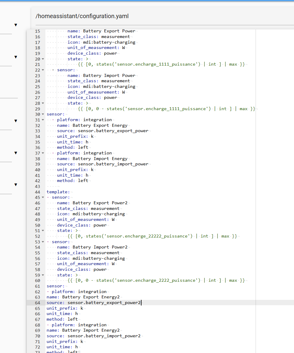

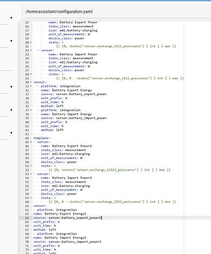

now i have this configuration :

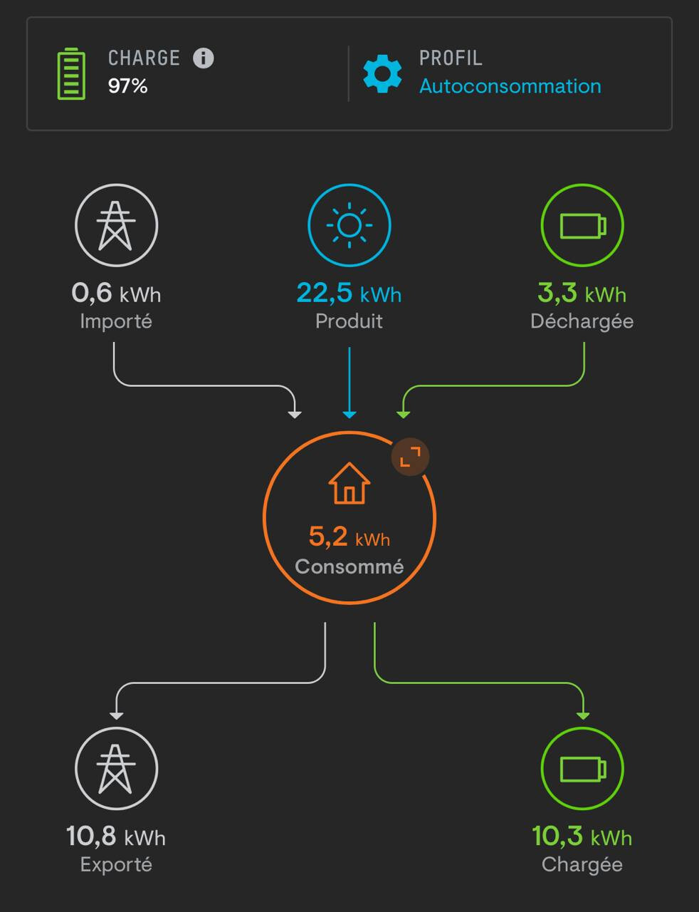

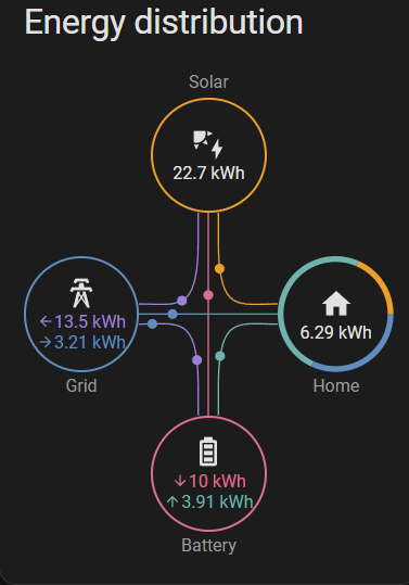

On my app i have
i have still some difference ::: ./
For the code i use:

Do you have an idee what is still wrong ?
Thx :slight_smile:
  • there’s still energy du jour in the solar production.
  • calcs look ok
  • Enphase app is probably balancing grid phases, export on one phase and import on another balances away, similar as electricity company would do.
  • Try tracking positive and negative changes in
    sensor.envoy_sn_lifetime_balanced_net_energy_consumption for grid import an export to get same values as app. Same construction as you have for the batteries already but withouth the riemann integration.

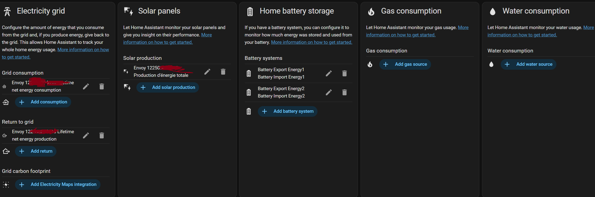

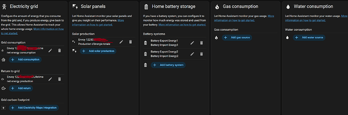

sorry for late answer also with “lifetime values” it s the same problem
i just saw that all people use riemann integration for the battery, but i dont thinks that it change something
But I guess perhaps i dont have the right “Electricity grid value” export ?

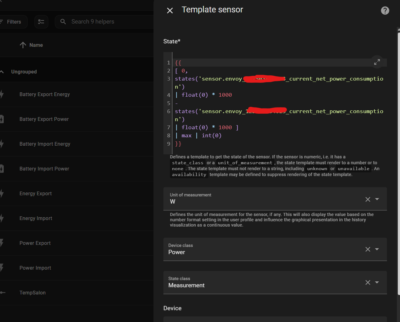

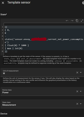

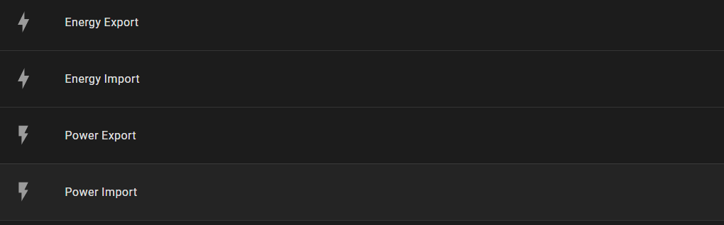

i guess i have to create and use helper like that ?

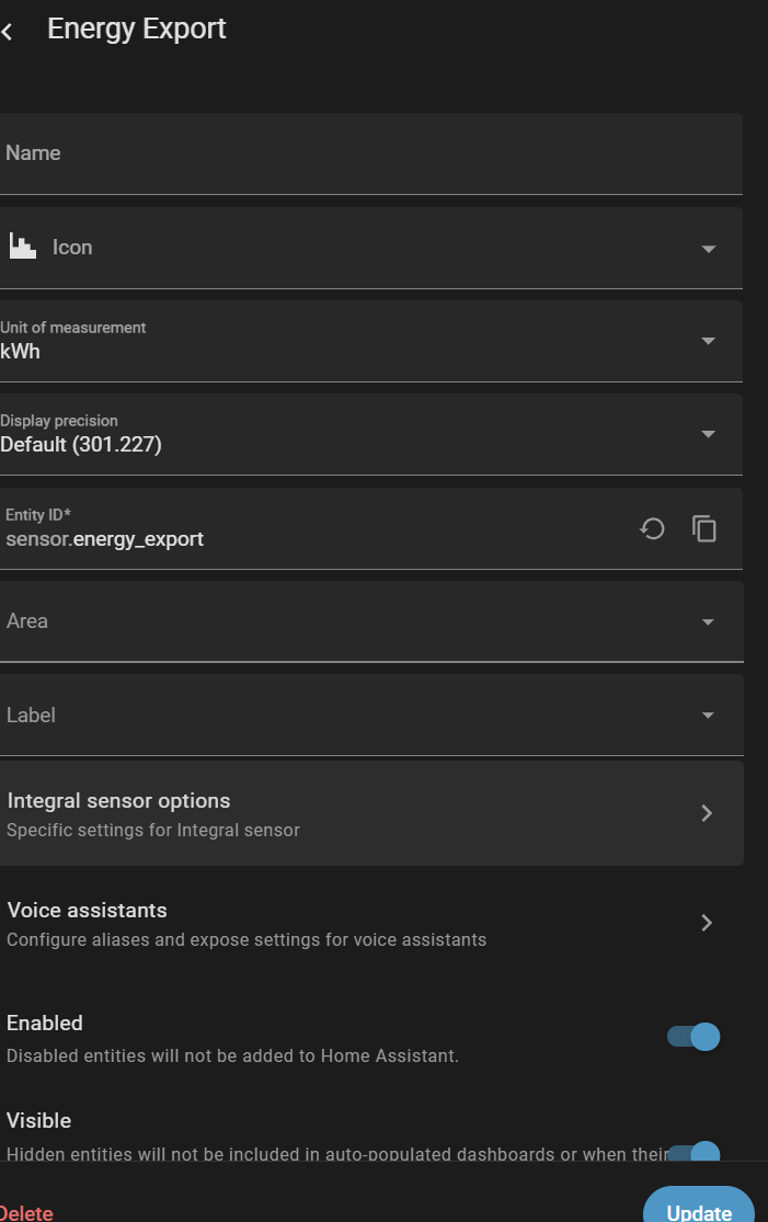

The right power export would be like that
and then integrate the export

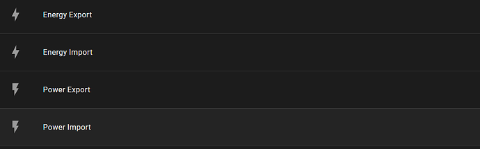

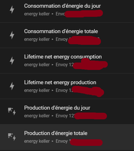

Sorry one more question , i dont understand what is the difference between “Consommation d’energie totale” And “Lifetime net energy consumption”
is that the same value, only change the language ?
Witch one should i use the dashboard ?
