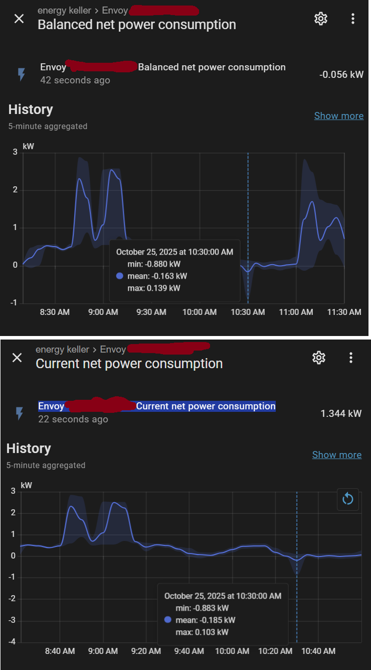

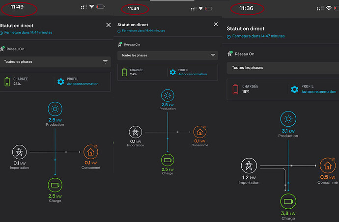

I dont understand why the value on the API cloud are correct but not for local API …
The measurements for the local API and the cloud API are performed using the same CT …
In my opinion, it has software processing/smoothing code so that users do not see export errors at night…

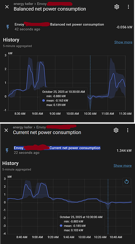

EDIT: here we can see also 'That “Balanced net power consumption” and Envoy xxxx “Current net power consumption” Give exactly the same mistake
See at time 10:30

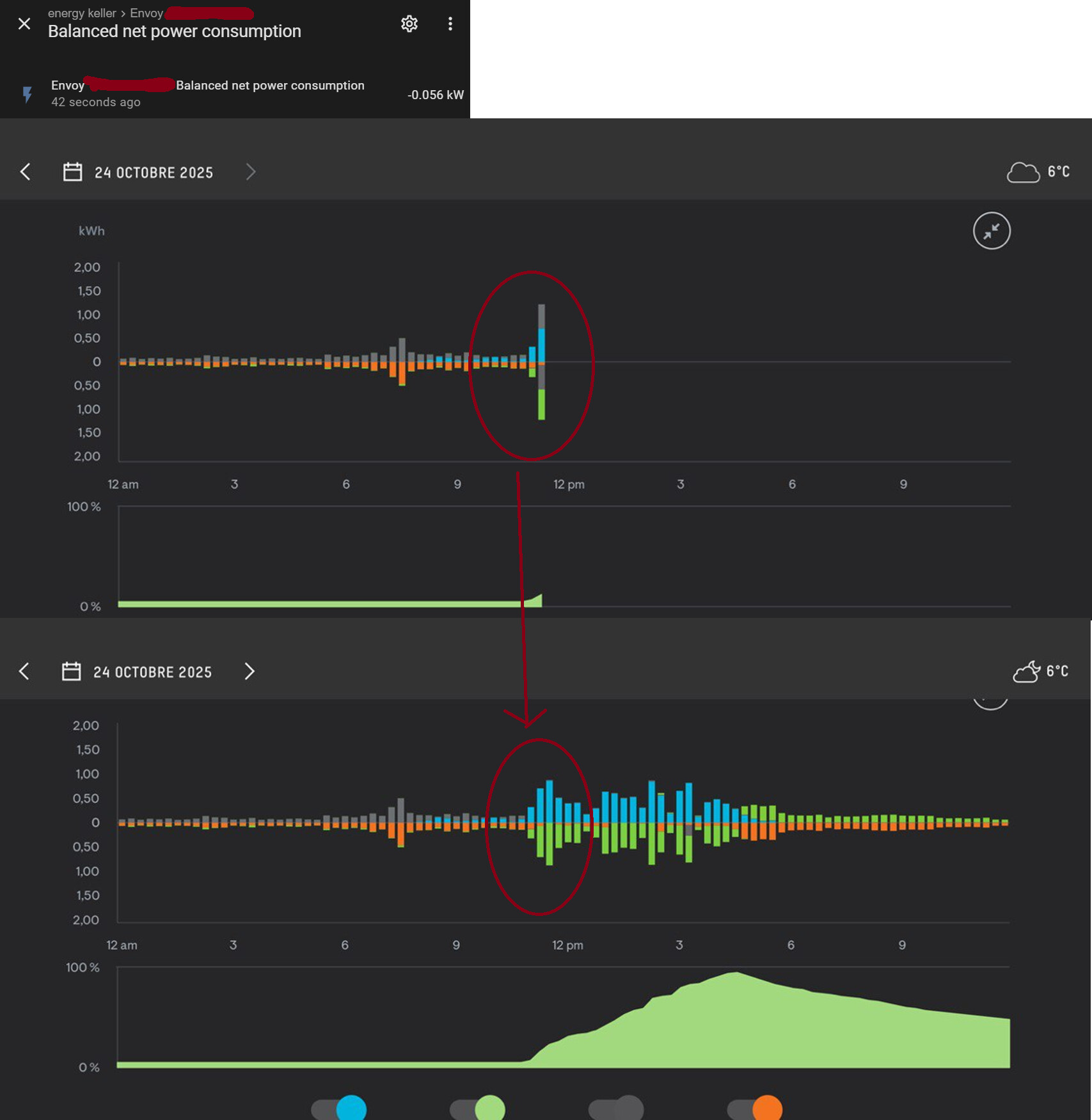

EDIT2:
Here we can see that, for example, on 24 October, Enphase was having a lot of trouble with the measurements… Yesterday the values were wrong, and this morning I see that they have been corrected as if by magic…
