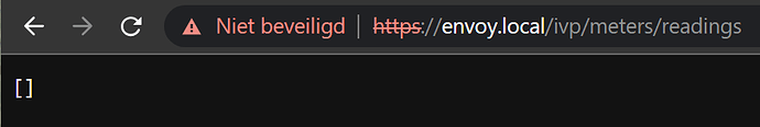

but maybe a stupid question:
if i open **HTTP**://envoy.local/ivp/meters/readings directly in my browser i get the json data. Why do i need to use a token ?
edit:
i think i see why… " * Software Version D5.0.62 (5e57a9)"
edit2:
interesting to see that no update is available in the enlighten manager
problem is the new firmware
browser has cookies en stuff… curl not
my token works only 12 hours… try now python script

I can’t get any value’s from the local URL.
I did create a API key with the /entrez-auth-token?serial_num= URL. And the API key works, I can access the local web page with it.
But there is 0 response from the REST call;
Well, there is a response, just a very very brief one, no values etc.
You can’t do it in the browser- or at least I don’t think so. You would need to send the authorization header. You need to to use curl
When I first hit the URL, it says that i need to authorize, i paste the api key, and the authorization dialogue goes away, and I get to see the empty brackets. What I know from rest, you should always be able to see it from a browser.
Anyway, I’ve also tried the rest sensor in HA. It’s created, but has a unknown value;
Solar Array Production
20 seconds ago
Unknown
I have a very new system, installed yesterday;
Software Version
D7.6.168 (f1975b)
Something wrong there, seems like rest calls are disabled or so…
----------------------- found the answer;
Apparently I have the Enphase Envoy Standard. And for these REST calls to work, you need the Enphase envoy-s-metered. I can do API calls to see the production of the inverters…
For the record; it is very well possible to test you REST api calls in the browser…
