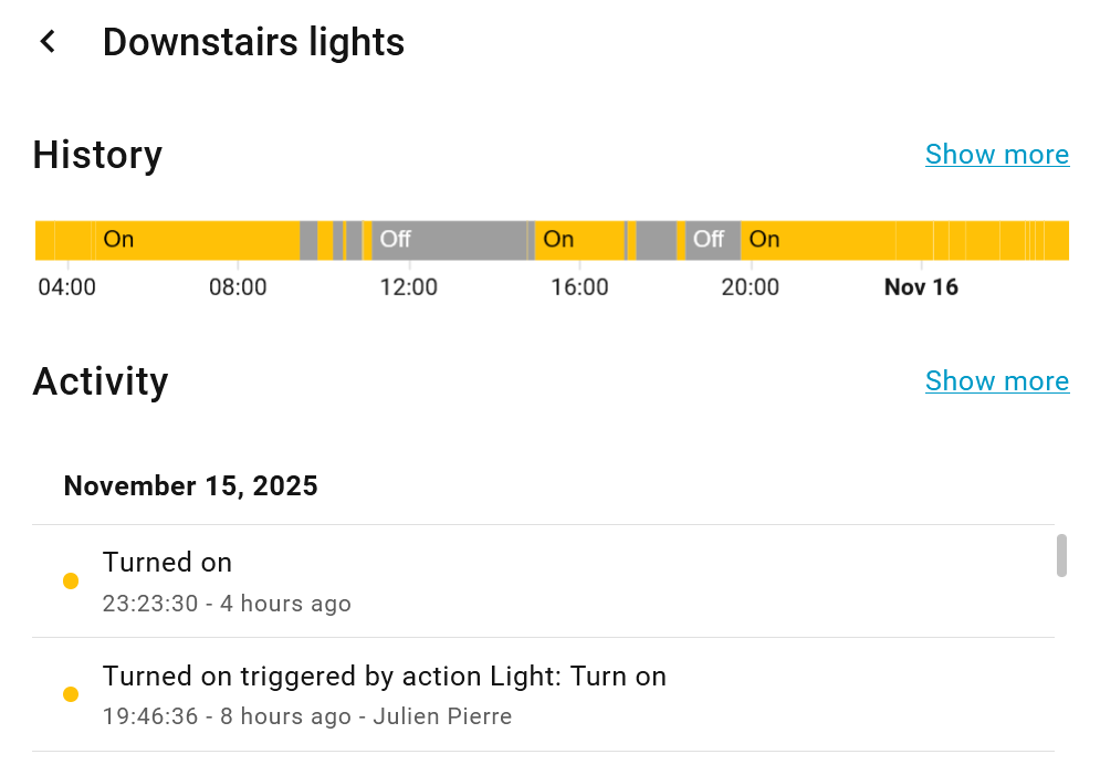

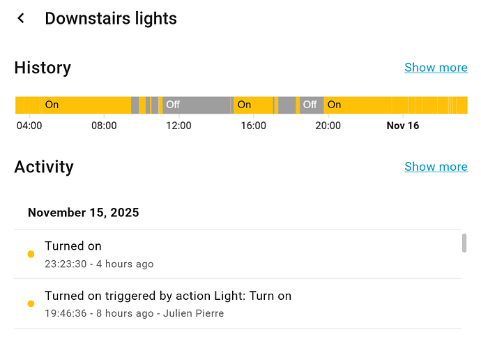

I just checked my HA log, and noted that I turned on my light group at 19:46:36, which is right after that last entry above . This is the time when I got impatient with the Z-Wave switches not responding, and pulled out my phone.
