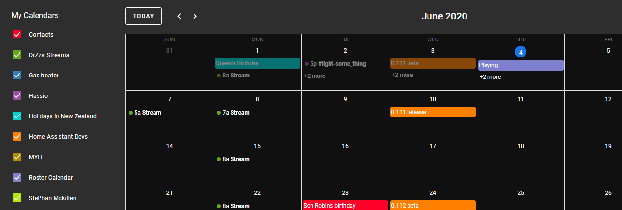

Entities Calendar - turn your entities into a calendar
This project started off with me creating a custom Lovelace Calendar card, based on FullCalender.io, but then HA 0.110 came along with its new Calendar panel ironically also based on FullCalendar.io. The only thing my card added, was support for displaying entities as well as calendars. So, I decided to turn that functionality into a custom component:
The component will allow you to create calendars based on entities, which will then show in the new Calendar panel.

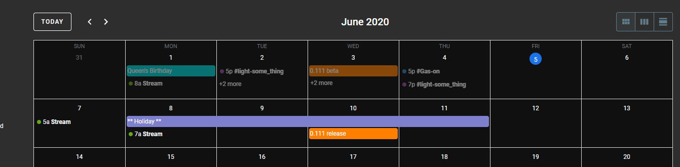

am i missing something
I have
calendar:
  - platform: entities_calendar
    calendars:
      - name: Roster Calendar
        entities:
          - entity: sensor.stephan_4x4x12
            start_time:
              timestamp_attribute: start_time
            end_time:
              timestamp_attribute: end_time
when i do a Check Im getting this
Invalid config for [calendar.entities_calendar]: [start_time] is an invalid option for [calendar.entities_calendar]. Check: calendar.entities_calendar->calendars->0->entities->0->start_time. (See ?, line ?).
and the sensor look like
which I build up from Python Script I wrote that runs when HA starts
if i do this
calendar:
    calendars:
        entities:
#            start_time:
#              timestamp_attribute: start_time
#            end_time:
#              timestamp_attribute: end_time
the check PASSES
but nothing in calendar I know as the sensor has a on/off status
which breaks the calendar ie no data is displayed
if I do this
i get
What am i missing
FIT IT added a name:
also manually down loaded a fresh copy
Roster day on the 8th is what I want to See
THANKS

All good bro
one Question
if there is a message attribute could that replace the name bit
where i have ‘stephan work’ is the name:
but as the sensor knows that im on holiday I have put in to the message part of the attribute
bee cool to show it there
looking at the code dont know where to change it still get my head around the python stuff
most of the time im breaking it love the ctrl+z
Thanks again for your hard work.
