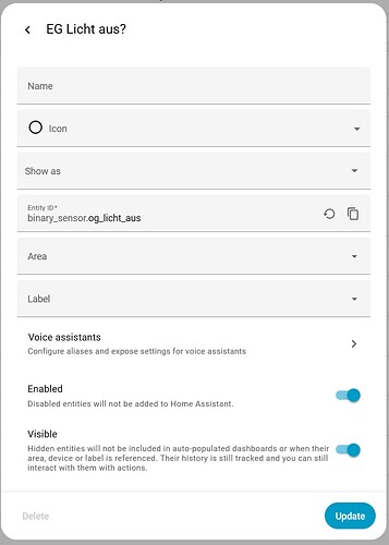

But the entities are as follows:
You can see: The names written in the YAML are not reflected into entity-names AND even worse, they intermix randomly.

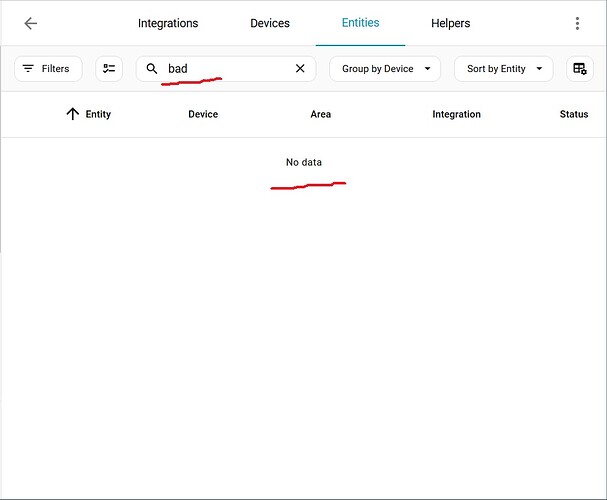

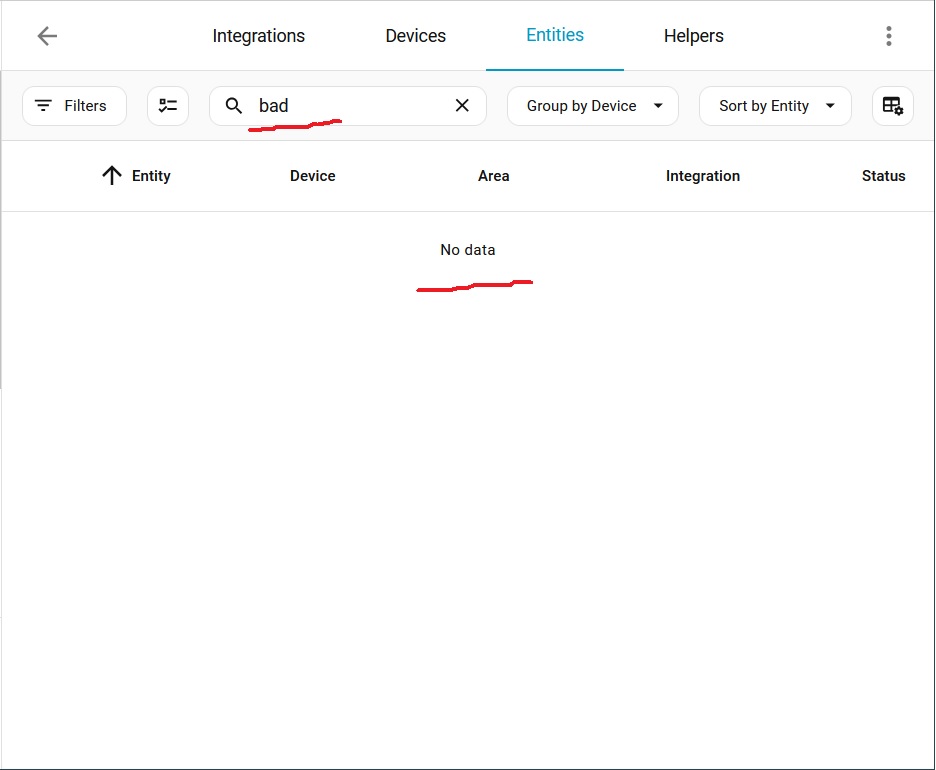

I still don’t understand why deleted entities are mysteriously coming back. After commenting out KNX, restarting HA and deleting all entities, e.g. “bad” can’t be found:

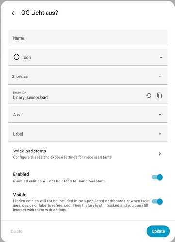

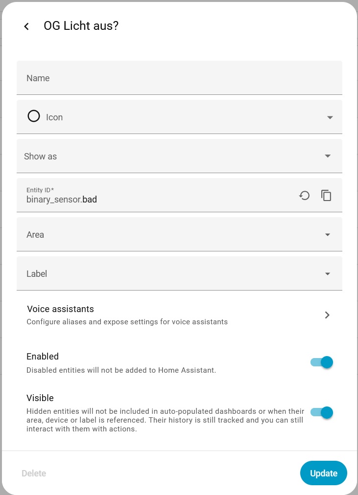

But when adding a totally different GA-name-combination, it is suddenly there:
For me this seems to be a database (SQL?) problem. Maybe deleted entities in the UI are not deleted in the database - but that’s just guessing.

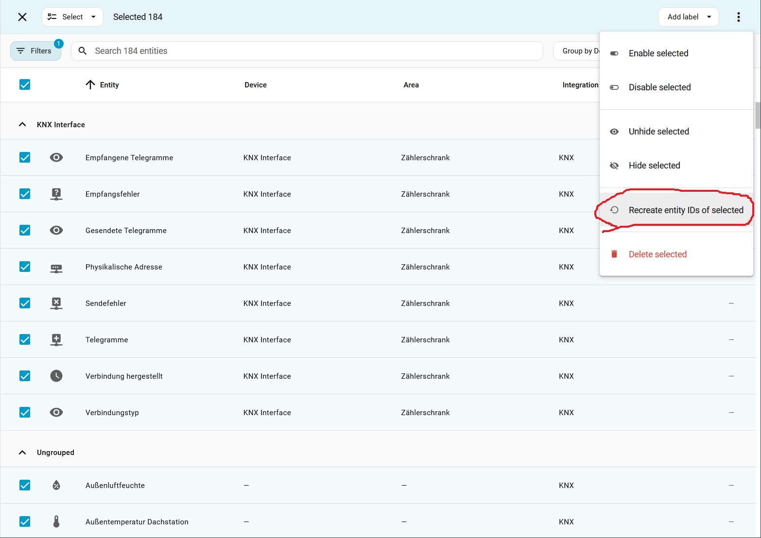

Anyway: I found the solution!
So, the updated steps to change KNX GAs within Homeassistant are as follows:
  • entirely comment out KNX in configuration
  • restart of entire Homeassistant
  • remove all KNX-related entities from Home Assistant (config/entities)
  • comment KNX back in
  • select all KNX entities and “recreate entity ID of selected” → this needs to be done several times until all duplicates are gone
Hope this helps others with the same problem :raising_hand_man:
