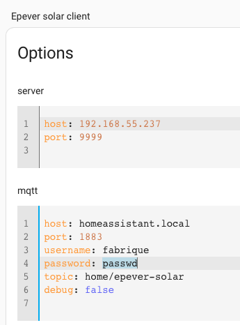

Capture d’écran 2024-12-31 à 16.21.50
i’ve user for HA which serve for mosquito too called fabrique
can’t add more screenshots or more replies :confused:
192.168.55.237 is epever ip
I’ve an epever upower high… i moved my pi next to inverter still can’t see something in mqtt explorer except $SYS …
heeeeelp … many thanks

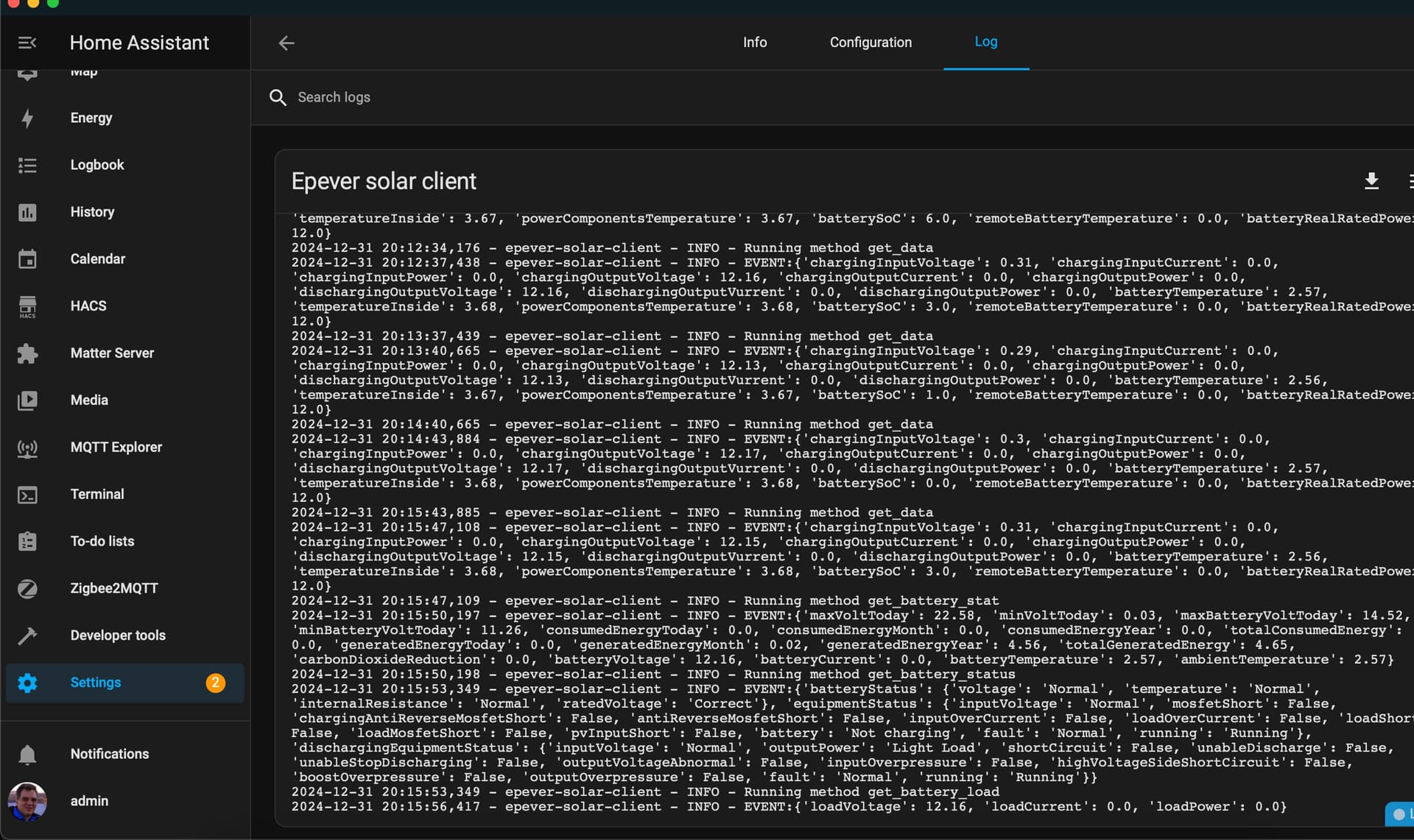

can you look to HASS logs?
here is example
hass-epever-solar-client log :
2025-01-01 12:22:14,726 - epever-solar-client - INFO - Running method get_data
2025-01-01 12:22:20,824 - epever-solar-client - ERROR - Modbus Error: [Input/Output] Modbus Error: [Invalid Message] No response received, expected at least 4 bytes (0 received)
2025-01-01 12:22:20,824 - epever-solar-client - ERROR - get_data
seems like it connect to 192.168.55.237:9999 because when rj45 wifi not plugged in inverter it is written in log :
2025-01-01 12:20:11,651 - pymodbus.logging - ERROR - Connection to (192.168.55.237, 9999) failed: timed out
2025-01-01 12:20:11,652 - epever-solar-client - INFO - Cannot connect to Epever server
when connected shows the 1rst message with modbus error …

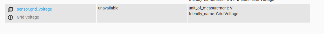

thanks for this but its always says unavailable. do you have any idea
so many thanks ! yes it was slave=10 for EPEver Upower high ! I did it with modbus as forking hass-epever-solar-client and modify code didn’t work for me and I wanted to try fast to know if it was the solution :wink:

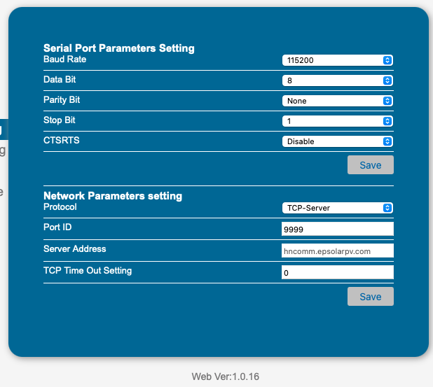

sorry but from what I understand , i have to set this parameter in the dongle MQTT settings and in the config client ?
I have a TRIRON 30A charger and i wanna connect with home assistant with the Epever wifi 2.4g rj45 d
i have already set the TCP-server mode in the dongle and i have installed the
hass epever client with success
thanks in advice
