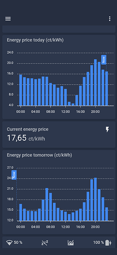

It is even much easier.
You can specify in the configuration of the EPEX integration the surcharge and tax. If you use this, you get the correct value in sensor.epex_spot_at_net_price.
If you now create a card like that:
type: custom:apexcharts-card
graph_span: 24h
header:
  title: Energy price today (ct/kWh)
  show: true
  show_states: true
span:
  start: day
now:
  show: true
  label: Now
series:
  - entity: sensor.epex_spot_at_net_price
    type: column
    extend_to: end
    unit: ct/kWh
    float_precision: 3
    show:
      in_header: before_now
    data_generator: |
      return entity.attributes.data.map((entry) => {
        return [new Date(entry.start_time), entry.price_ct_per_kwh];
you should get something like this (please be aware that I have another provider with slightly different prices):
