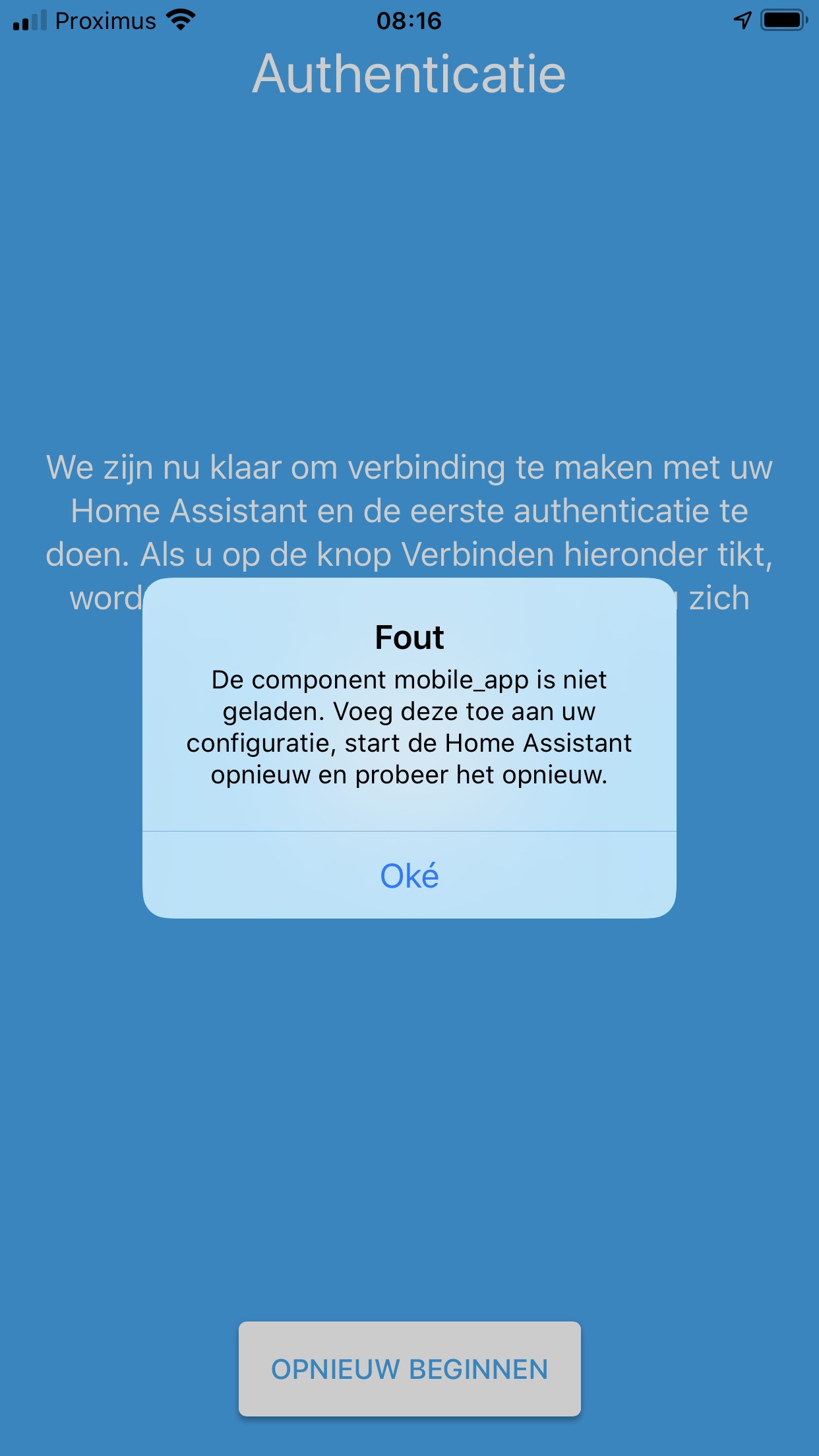

I upgraded to 2.0 on iPhone 7plus running iOS 13.2.3. Upgraded my hassio to latest version 0.102 installing on my home network. Finds my ducks s instance. When logging in I always get error message box that mobile_app is not loaded. I should put it in config and reboot.
I tried deleting the iOS integration, rebooting and installing iOS app from scratch. Does not work. I cannot Find anything in docs about manually adding mobile_app. What am I missing?
OK RTFM for upgrading early in the morning before my second coffee…
I needed to load mobile_app: in the config. Finally found that in docs. I am leaving this here to educate others!

For the benefit of anyone else finding this post in the future. Please add default_config: to your configuration.yaml file. This enables multiple components.
The migration guide can be found at: https://companion.home-assistant.io/getting_started/migration
