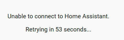

Today I upgraded the core version from 2025.5.1 to 2025.5.3 and suddenly the HA webpage was not loading anymore.
After a lot of doing through the CLI I found your post and it worked for me too.

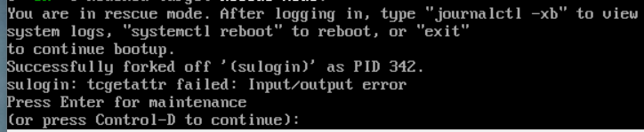

LIFE SAVER. Ironically, before this happened, I was installing the Advanced SSH & Web Terminal addon. For some reason, it crashed mid-install. So now I can’t even SSH into it. banner command never worked, but it eventually booted into rescue mode.
I looked for the addons.json and opened it in Vim (vi /mnt/data/supervisor/addons.json). Looked for the section that mentioned SSH and changed the boot key from "auto" to false (no quotes). Afterwards, I exited with exit and supervisor finally worked!
