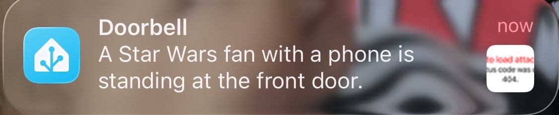

I am using LLM to assess snapshots from my doorbell camera and provide notifications based on the assessment from google gemini. The messages are working as expected but keep getting an error with the image in the mobile notification. Not sure where im going wrong.

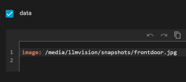

Mobile Notification Image config

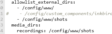

set dirs:

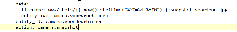

then make snapshot
usage in notifcation
