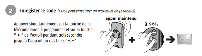

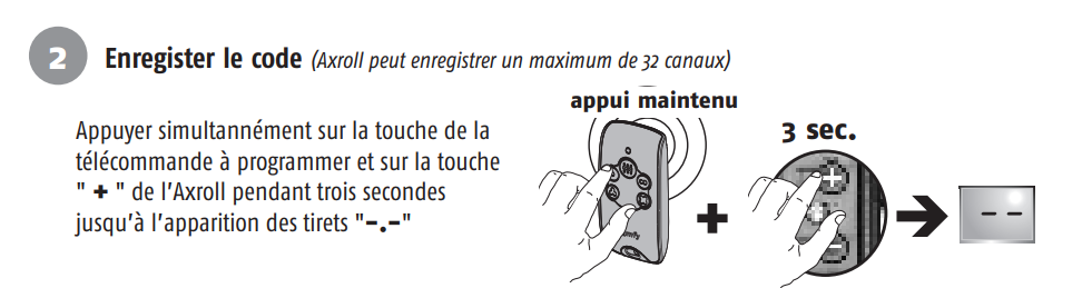

Hello, I’m trying to pair my Axroll roller shutter. The frames from the remote control are correctly detected.
However, the procedure to add a new remote requires pressing a button on the roller shutter control box for 3 seconds at the same time as the button on the remote control to be configured.
There is only one button on the remote.
Is there a way to simulate a long press in ESP Somfy RTS when adding a roller shutter?
2. Register the code
(Axroll can store up to 32 channels)
Press simultaneously the button of the remote control you want to program and the “+” button on the Axroll for three seconds, until the dashes “– –” appear.

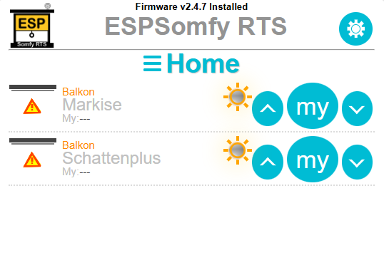

What does the attention icon means?
Really no idea
myself, sent “wind” status via virtual remote.
