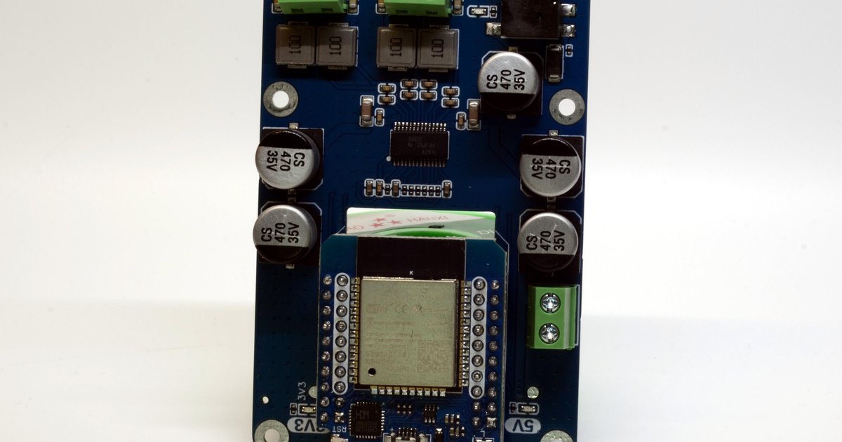

I’m the developer behind Louder-ESP as well as HiFi-ESP and Loud-ESP docks.
I actually participated in github discussion and installed and tested myself squeezelite-esp32 on all listed boards. I put down step-by-step instruction on how to do so.
I’m working on updated version of the Louder-ESP right now. It should add 45W mono output, aluminum case, USB PD and few extras. I’d be happy to hear some feedback from anyone using or planning to use one of those boards. I’m ready to answer questions if there are any.
@stuartiannaylor You’re right, they are no competitor for full size amps and speakers set, that you can buy now for peanuts, and that’s why I made (and use myself) an HiFi-ESP.
But for multi-room or ceiling speakers fair 15W is more than enough, I’m sure you’ll agree .

Hey guys. Just letting you know that I’m starting Crowd Supply campaign for the upgraded version of the Louder ESP (and the family). I is accumulated community feedback, for which I can be only grateful
it has onboard Wroover module and external antenna (to address connectivity issues)
It has ethernet onboard (alternative to WiFi), not on the image yet
It is powered via USB power delivery (and will be shipped with one)
It is cased in Aluminum case, and I’m planning to thermocouple it with DAC, so you should be able to get maximum power out of it without overheating
It has onboard IR reader
It has mono mode via jumper
It would help if you subscribe to the campaign, so I can better understand the demand and the end cost of the unit.
