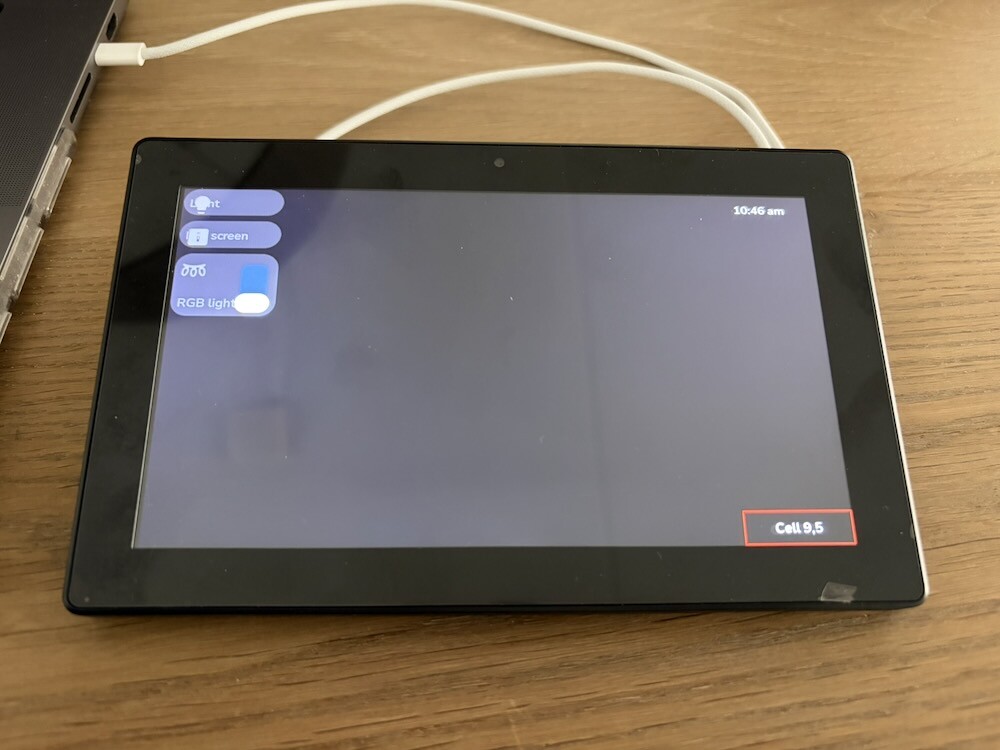

and I am sure I got a color correct LVGL test screen
but atfer adding my LVGL code I directly noticed that the color_order swapped from RGB to BGR!
No when I go back to my last working code (above) i still get this:
Is there someone who figured this out?

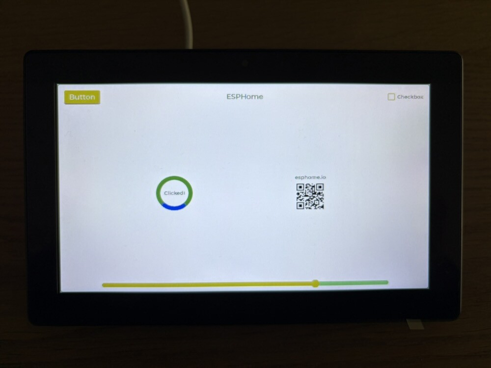

Your code gave me the needed hints for solving my issue: with this code my screen now is correct again. — Thanks!
esphome:
  friendly_name: "1060p600"
  min_version: 2026.3.0
esp32:
  board: esp32-p4-evboard
  variant: esp32p4
  flash_size: 16MB
  cpu_frequency: 360MHz
  framework:
    type: esp-idf
    advanced:
      execute_from_psram: true
      enable_idf_experimental_features: true
psram:
  mode: hex
  speed: 200MHz
logger:
  level: DEBUG
api:
  reboot_timeout: 0s
ota:
  - platform: esphome
    password: !secret ota_password
http_request:
update:
  - platform: esp32_hosted
    icon: mdi:chip
    type: http
    source: https://esphome.github.io/esp-hosted-firmware/manifest/esp32c6.json
    update_interval: 6h
preferences:
  flash_write_interval: 5min
wifi:
  reboot_timeout: 15min
  power_save_mode: LIGHT
  fast_connect: False
  enable_btm: False
  enable_rrm: False
  passive_scan: False
  enable_on_boot: True
  post_connect_roaming: True
  min_auth_mode: WPA2
  ssid: !secret wifi_ssid
esp32_hosted:
  variant: ESP32C6
  reset_pin: GPIO54
  cmd_pin: GPIO19
  clk_pin: GPIO18
  d0_pin: GPIO14
  d1_pin: GPIO15
  d2_pin: GPIO16
  d3_pin: GPIO17
  active_high: true
esp_ldo:
  - channel: 3
    voltage: 2.5V
    adjustable: True
  - channel: 4
    voltage: 2.7V
    adjustable: True
output:
  - id: gpio_backlight_pwm
    platform: ledc
    pin: GPIO23
light:
  - platform: monochromatic
    output: gpio_backlight_pwm
    name: Display Backlight
    icon: mdi:lightbulb-on
    restore_mode: ALWAYS_ON
    default_transition_length: 0s
    gamma_correct: 1.0
i2c:
  - id: bus_a
    sda: GPIO7
    scl: GPIO8
    frequency: 400kHz
touchscreen:
  - platform: gt911
    reset_pin: GPIO22
    interrupt_pin: GPIO21
    address: 0x5D
    transform:
      swap_xy: true
      mirror_x: false
      mirror_y: true
display:
  - platform: mipi_dsi
    model: JC1060P470
    update_interval: never
    reset_pin:
      number: GPIO05
    hsync_pulse_width: 20
lvgl:
  byte_order: little_endian

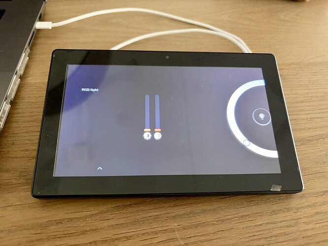

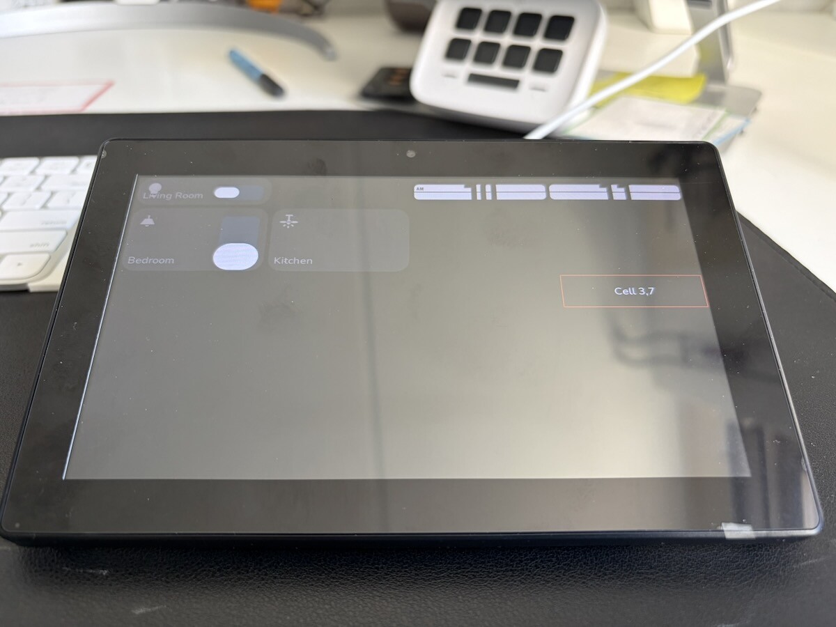

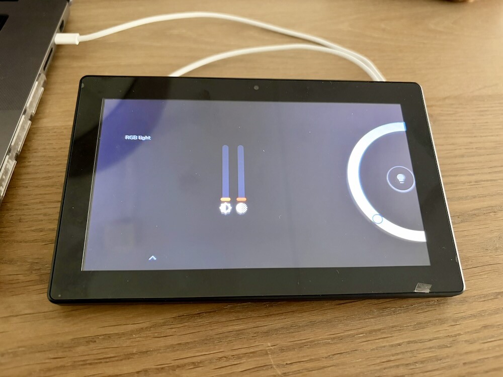

Nice! Can you test my code? I would like to add that screen to the list of screens I support?
that will take some time… — I manage my esphome direct from HA (in browser) [do not ask why :)]
I do the same thing you can do a git check out from command line just install the Advanced SSH & Web Terminal app
it complained about this line: rotation: ${rotation | default("0”)} so i commented it out. the result looks OK:
That doesn’t looks good the clock is all squinched up. I just made a bunch of changes to the codebase. It now supports LVGL screen rotation.
Can you update to ESPHome 2026.4.0, download the latest code from my git and build it again?
I am already on 2026.4.0 and have little time to debug: name was missing in the esphome stanza
esphome:
then it gave me:
http_request: [source /config/esphome/lvgl-buttons.yml:40]
Component http_request requires component network.
I’m not sure if this is responsible, but since updating, the RAM usage during compile has increased from 10.1% to 20.2%. Have you seen anything similar?
You don’t need to debug but you do need to build this. The hardware file is not designed to build by itself.
I do not monitor RAM usage while compiling.
INFO Reading configuration /config/esphome/my-panel.yml…
ERROR Error while reading config: Invalid YAML syntax:
Error reading file /config/esphome/esphome-modular-lvgl-buttons/widgets/swipe_navigation.yaml: [Errno 2] No such file or directory: ‘/config/esphome/esphome-modular-lvgl-buttons/widgets/swipe_navigation.yaml’
the swipe code is in /common now.
Try building this one. I am interested in seeing if this files works but I don’t have a screen to test.

Hello everyone,
I ran into some display issues with my screen, but after quite a bit of searching, I realized that there is a newer version available on GuiTion’s drive (GUITION-DISK · 网盘).
This version distinguishes between “old” and “new” panels, and further investigation revealed that the initialization sequence has changed.
In fact, a label on the ESD packaging lists the SKU as 10153004-V2.
So, I will need to create a V2 version in ESPHome to ensure compatibility.
I got the newer model’s screen working properly by looking at the changes made in this project for the new hardware: https://jtenniswood.github.io/espcontrol/
From there, I used a stochastic parrot LLM to reverse engineer what they changed to get it working and shoe-horn it into this revised yaml that seems to do the trick.

I hope this helps!
Thanks for your help, it works for me too :slightly_smiling_face:
