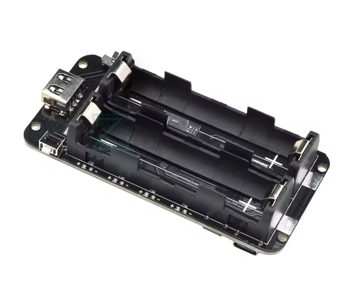

Does that battery pack protect your batteries from over discharge (assuming they are lithium).
Does that battery pack supply a regulated output voltage, and if so, what efficiency?
I know these battery shields. What exactly is your project?

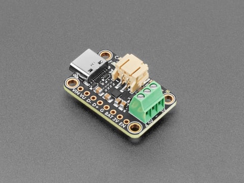

To get any reasonable power out of small panel, you need solar charger. Otherwise the charger tries to draw more than panels Impp causing the voltage to collapse.
Something like this:

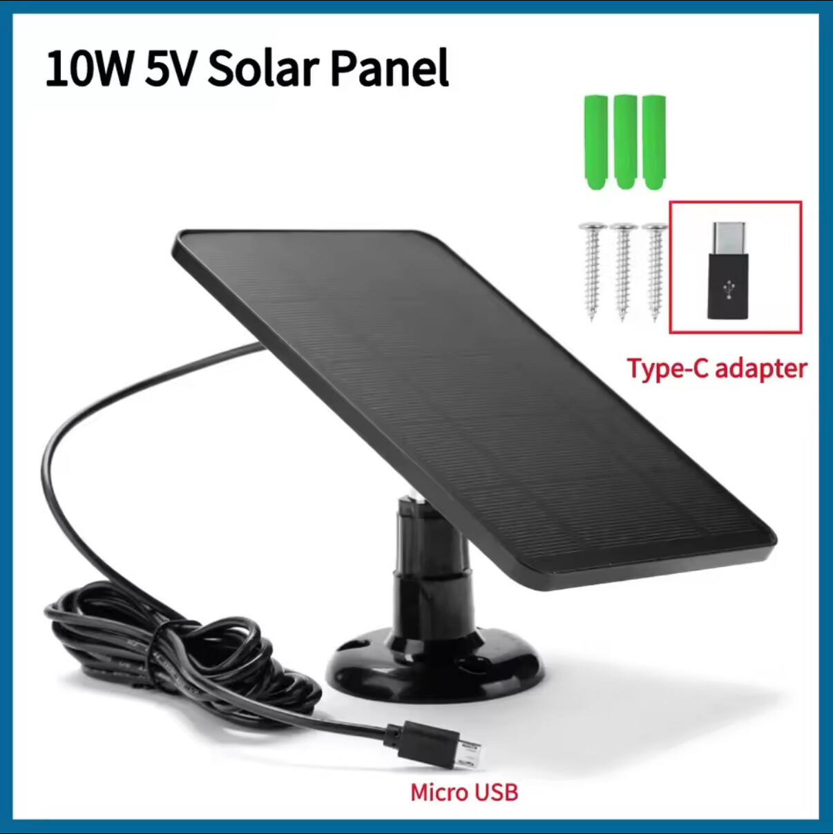

Then I also tried charging the power bank alone with the 10W 5V solar panel and it charged in about 5 hours (more or less).
I live in Italy and the sun is always there.
That’s 2A, quite big panel . If you set regular charger to max 1A, it should work quite well.

The major problem will be that particular battery shield. Below a certain current draw the shield will shut down and only provide power again when you press the tactile button on the side. Also if the shield shuts down due to battery going low and protection jumps in you will have to remove the batteries and reinsert. The shield has no power path

Don’t believe the 10W power advertised by the seller unless you have measured it yourself.The temperature sensor is relatively easy but air quality sensor might be too much of a power drain depending on what you choose.

I went through a ridiculous number of solar panel refunds and returns until I got an actual 5V 5W (peak) panel.

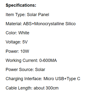

Size can give some indication if panel Wp is totally fake or not.
10Wp poly panel should to be at least 700cm2, like 20x35cm.
Saw this on ebay. Only a third the surface are you suggested. Things don’t add up. It is monocrystalline though. LOL
Buyer beware
0.6A at 5V gives 3W…
yup! Can’t trust anyone.

This is my solar panel:
It’s 175x120mm (it’s typeC with no adapter)
It is normally used for IP cams
~2W panel, I have one like that connected to my Reolink cam. Does the job for it.
