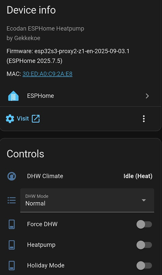

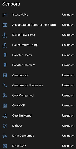

I’m quiet new at HASS. I just installed all possible stuff on Ecodan heat pump but I have a few issues with uderstanding how it works:
- esphome-ecodan-remote-thermostat - honestly I don’t know how to link Remote thermostat with “climate” from YAML? And how to create a new thermostat for ecodan? Because I have 6 zones which I would like to link with “Simple thermostate card”.
- ESPHome Ecodan heatpump - Server control - what is actually do when you enable this function? On FCT screen apears a “globe”, so something happens.
- For Auto Adaptive Control, Short cycle detection & mitigation etc. Where can I fing YAML code to edit in HASS? I checked all folders with “File explorer add-on” but couldn’t find anything. How to enable Auto Adaptive control

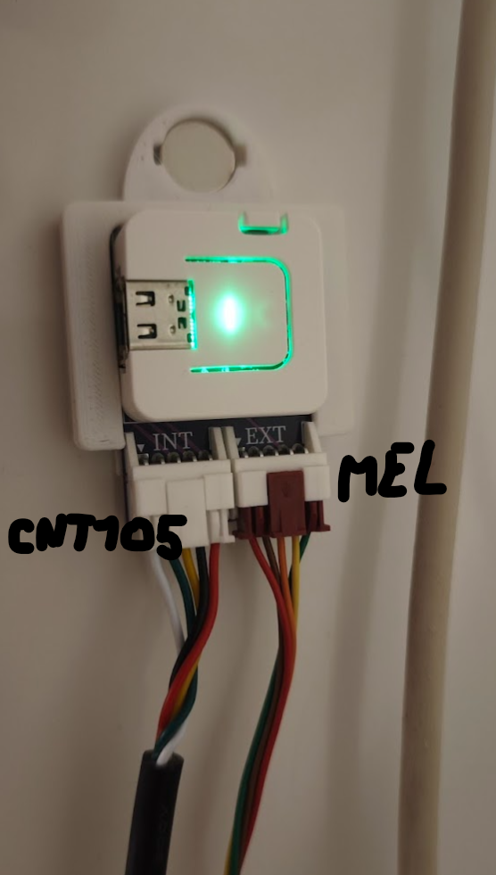

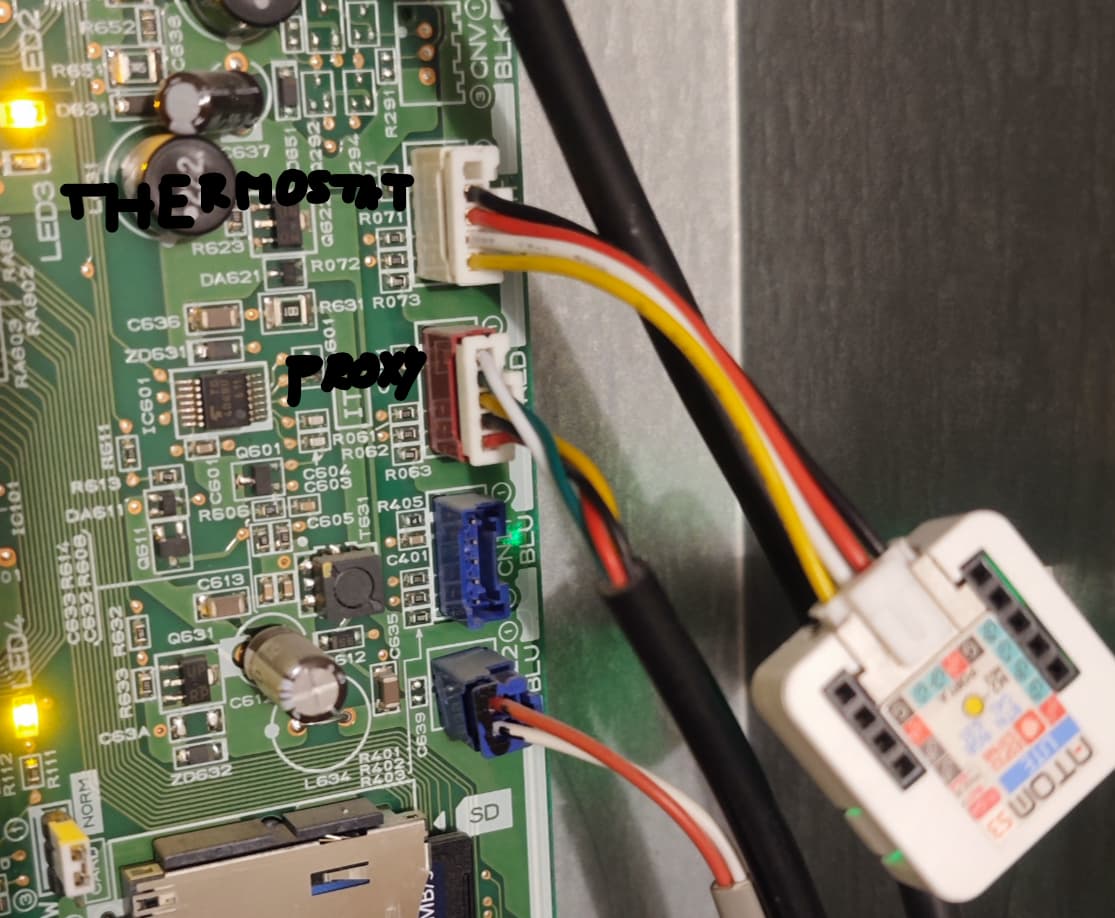

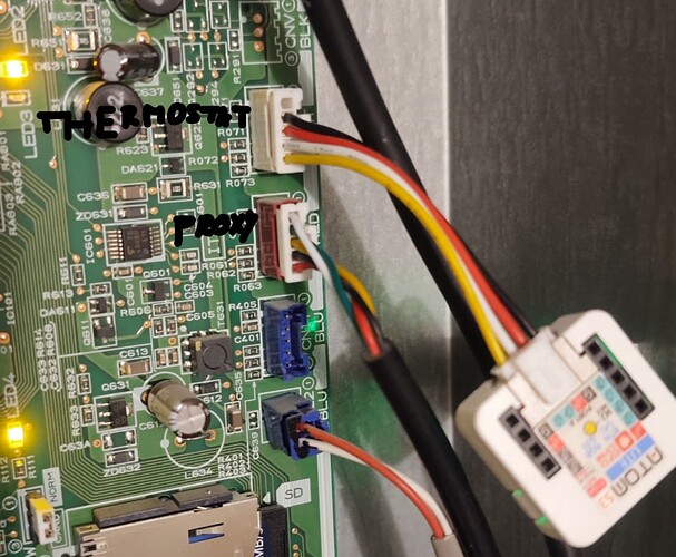

- Proxy setup - I accuierd a adapter from fonkse, but after installing “proxy” version on ESP and connecting to FCT5 and Melcloud I can not do anything. HASS does recognize proxy setup, but all data are blank or unavailable.
Thanks in advance.

- Did you have the correct software installed? in HA, settings > devices > esphome, click op the ecodan heatpump. What version does it show?

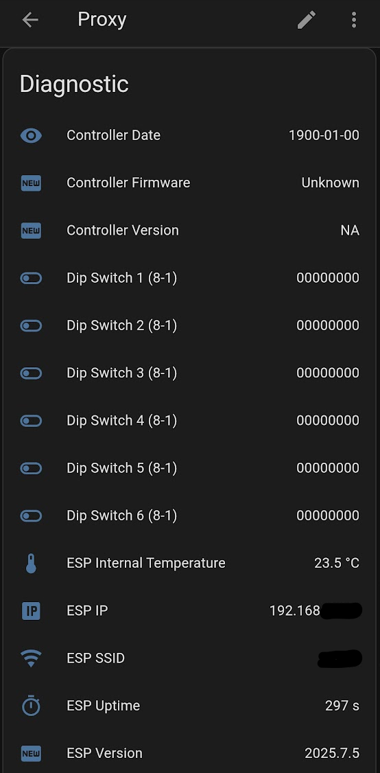

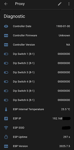

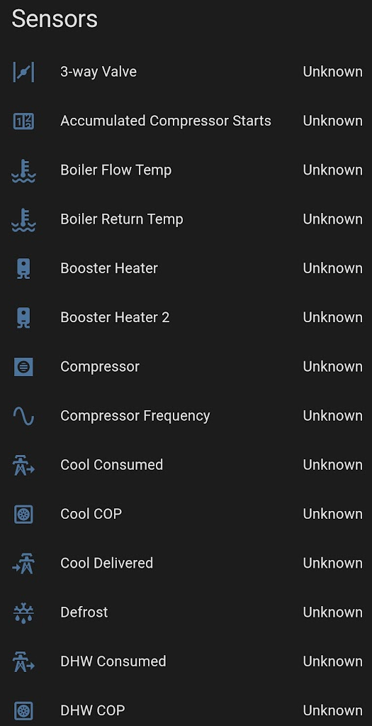

- Yes, I installed the proxy firmware, but all data were unavailable. I will try to recreate this and make you a screenshot.

I thought no data was available? (4) so there was no connection to the heatpump, you probably need to fix step 4. For settings to be reverted, it seems that something is setting the values. You mentioned using proxy, so probably melcloud is doing something ?
you could try to run without melcloud adapter and see what it does. (power down unit first before removing melcloud adapter) -
Sounds like you are using a broken esphome or wrong firmware file if installed from my binaries. Which one did you use?
But I don’t really understand, if you can activate a “globe” then you clearly have a connection and should be able to see the data.
If I have ESP connected directly to Ecodan it works pretty well, except for this missbehave when I can not adjust anything. If I try to enable/disable server control, globe apear (enable) and dissapear (disable) on the display. I don’t know why temperature and “operation mode” does not do anything. But this I didn’t figure out yet, why one day is working fine, the next day it’s not. Maybe it has something to do with powercycling the unit (needed to clean the filters).
Data not avaliable happens only if I have both things connected (Melcloud and esp proxy).
I will try again in couple of days (hopefully earlier) and I will get back to you with a report. Maybe it has something to do with electronic type? I have FCT5.
Sounds like melcloud adapter is not working properly. did you just use my binaries? I’m guessing you compiled it yourself?
Does the melcloud adapter works if you connect it without the esp ? When we are in proxy, the esp acts passively, it expect the slave to initiate the connect, might be that your melcloud is not working correctly, please verify if it works stand alone
Don’t enable server control when melcloud is connected, does everything works normally then? Probably melcloud cannot handle server control.
If you compiled from source yourself, Try one of these
In my project you can run proxy + server control and outdoor sensors in parallel because MELCloud is slave to ESP.
Commands are forwarded on demand if MELCloud requests a write operation.

I used binaries for all (ESP - Ecodan, ESP Thermostat and ESP Proxy).
If I connect like proxy, Melcloud connects to the internet (at least Melcloud app detects it), EPS connects to HASS but doesnt show anything. Mellcloud adapter was in use until I decided to integrate everything into HASS.
All the upper photos are before enabled “server control”. I will try also with server control enabled today.

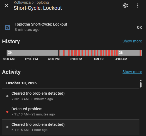

Maybe another question. Short cycle lockout cycle → I’ve got “problem”. How can I know where the issue is.
Thanks
It detected short cycles, But that is weird since it does not seem to connect. You can disable it by setting short cycle lockout duration to 0 for now.
please flash this https://github.com/gekkekoe/esphome-ecodan-hp/releases/download/2025-10-05.6/esp32s3-proxy2-z1-en-2025-10-05.6.ota.bin
It fixes an incorrect short cycle detection, that’s what you are seeing (unknown states)
can you enable uart logging on the cn105 esp and paste a part ? I think it does not do connection.
btw, what melcloud adapter type do you have? One of the first very old model does not work properly. Is it a PAC-WF010-E ?

UART Logging do you mean for proxy or for “regular”. Because the screenshot I gave you are from Firmware: esp32s3-z1-en-2025-10-05.6 (ESPHome 2025.7.5).
You’re right. It’s PAC-WF010-E.
