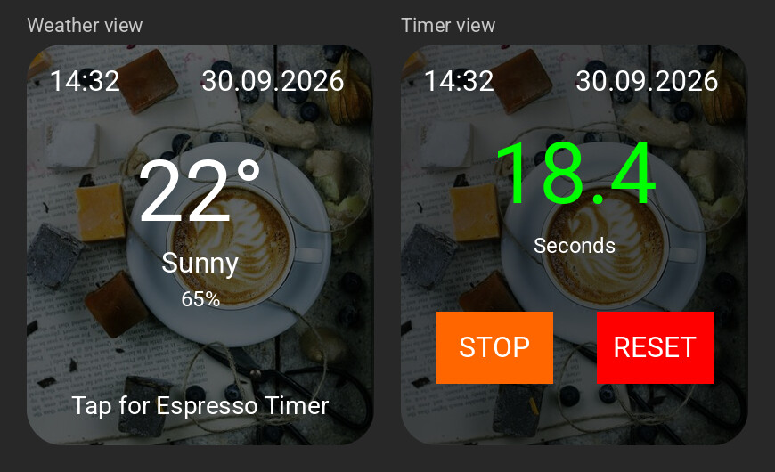

A small touch display next to my espresso machine that does two things:
  1. Shows the weather (outdoor temperature, condition, humidity) plus time and date while idle.
  2. Times my espresso shots. Tap the screen and the timer counts up from 0.0 s. The color tells me how the shot is going:
    • 0-24 s: green
    • 24-35 s: green, then yellow, then red
    • 35 s and more: red
Preview of the weather view and the timer view
Preview (simulation): weather view on the left, running timer on the right.
It is built on ESPHome with LVGL. Everything is configurable from Home Assistant, and the timer can be driven by automations.
