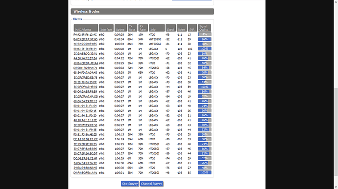

my router does appear to see the devices (all the LEGACY devices), they are all listed under the “status” bar under “wireless nodes” but when I check the network with my “fing” app they don’t show up and they also don’t register with HA.
I’m not sure if they are or are not connected to the router now?

Also what is ath0 and ath1 interfaces?
None of the DIY devices are set static IP addresses. Maybe that is an idea but there are probably about 30 of them and they don’t need to be static to work but might solve this. Static is for CCTV and hassio etc. Devices where i need fixed IP only. For static address on ddwrt I only ever need to assign Mac address, desired IP and device description.
Ath0 is 5ghz and not relevant for legacy ( also given a separate name which is not on the Arduino code) and the ath1 is 2.4ghz

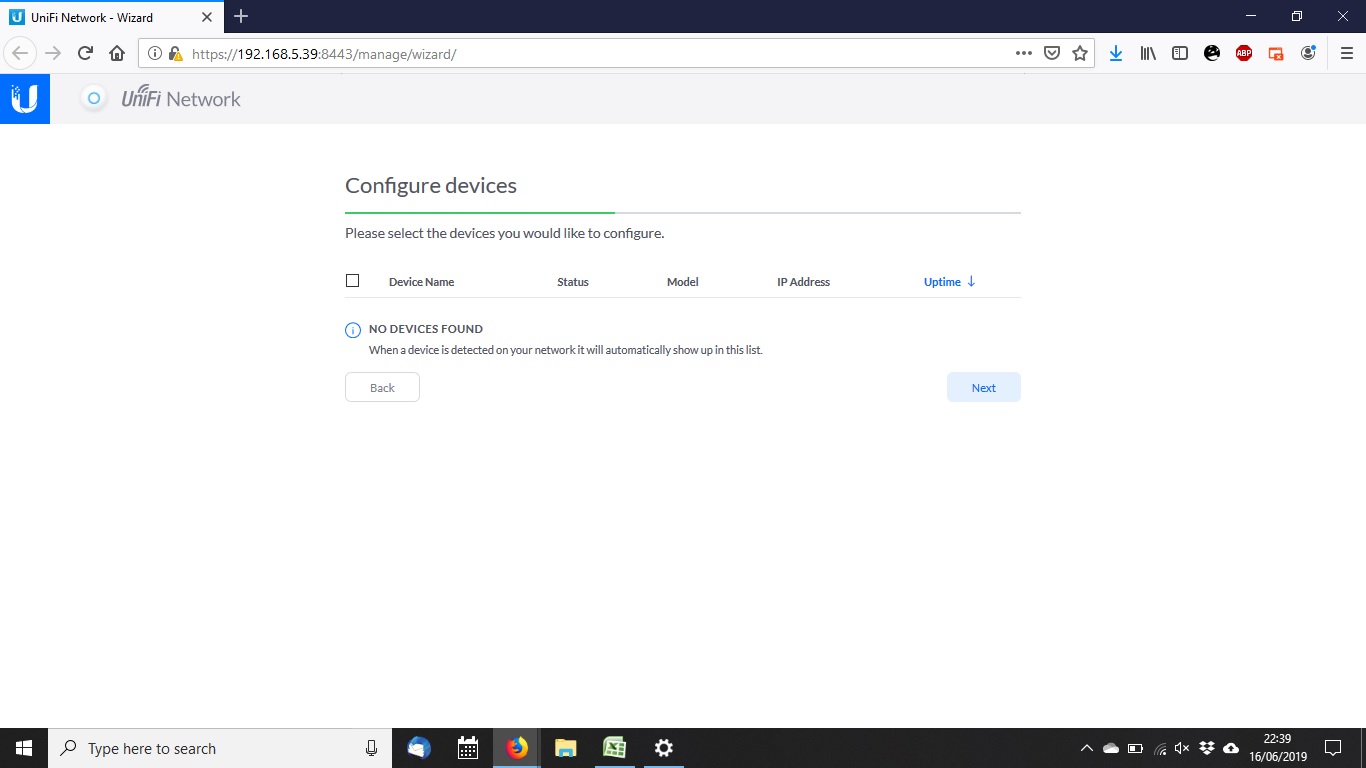

The unifi AP arrived today and it;s plugged in and I’m connected to it. For some reason the conttroller is not picking up the AP
From the Android app I was able to change the SSID details but nothing else.
What am I doing wrong here?

On the discovery I can (or at least I could, that isn’t working anymore either) see the AP so it’s just acting as a wifi extension at this stage and I can only change the ssid details from the android app.
Are you sure I don’t need a USG, I don’t understand how the AP can set static IP devices for my devices like HASSIO etc?
How can this AP do all that? This is a very confusing to set up…
I’ve dissabled my firewall and tried to control from PC, then from HASSIO but nothing is getting onto the controller. The only thing thats working is the android app, with that I can switch on and change the SSID to what I need.

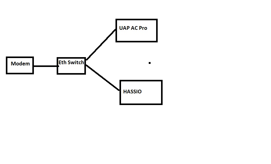

Have you connected your AP straight to your modem?
Mine is modem into ethernet switch/splitter one into AP and one into HASSIO
