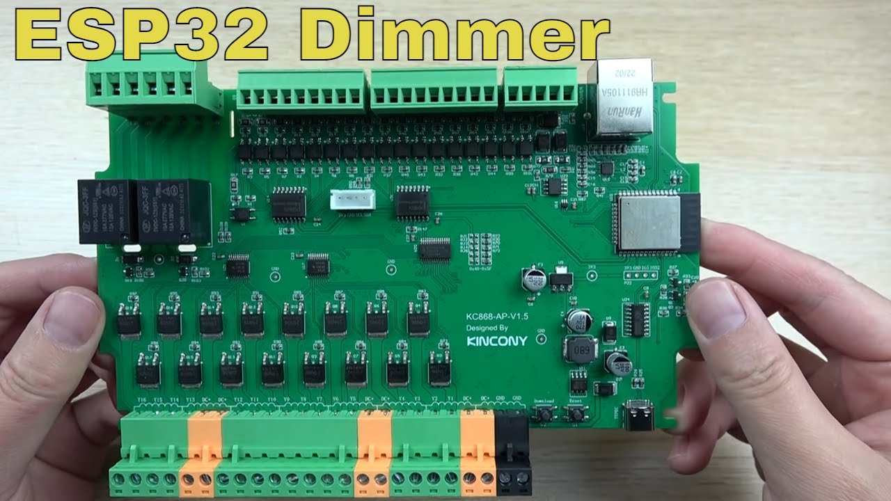

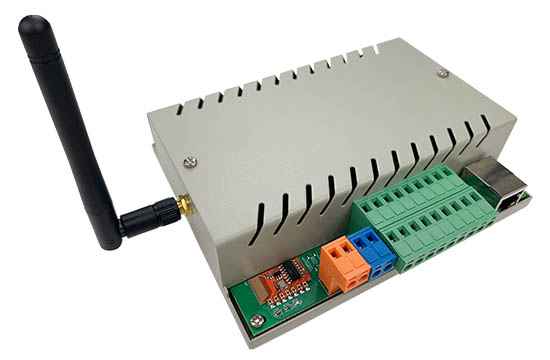

I also came across this ethernet solution:
A demo of the 8 channel version:
These seem very promising. It’s completely low voltage. You have to buy seperate LED drivers or solid state relays, which you can buy good brands of from trusted sellers.
https://nl.aliexpress.com/item/1005004758371598.html
Just saw the youtube video of a new Kincony ethernet dimmer based on ESP32, open source:
