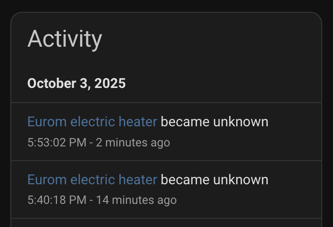

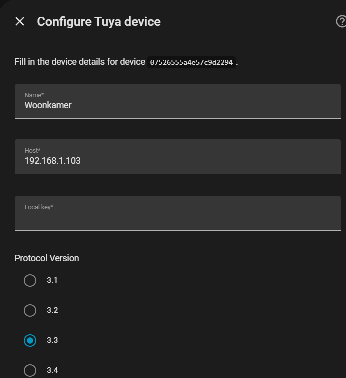

Hey… I have the Eruom Alutherm Heater 1500 wifi.
No matter what I try as configuration settings, as soon as I press submit I get the notification that the device became unknown in Home Assistant.
Never even got the climate settings shown up.
When I start the Add device entry it picks up the device with the correct IP address but stuck after submit.
Any pointers?
I have the “EUROM Alutherm 800XS” and use this post to integrate the heater in Home Assistant. Via this post I want to share my configuration. To configure localtuya I used this guide to retrieve the local key.
With this configuration I can configure mid/high/low/off and and configure the mode (manual/auto).
  • Target temperature I use 2
  • Current Temperature I use 3
  • HVAC Mode DP I use 4
  • HVAC Current Action DP I use 1
  • Presets DP I use 5 (this one deviates from most other configurations I see in this post)
  • HVAC Current Action Set (optional) is set to true/false (don’t know if this is correct).

Now, clicking on local tuya - add device - he finds my Eurom.
There is clearly something wrong, I got many time this warning: Connection to device succeeded but no datapoints found, please try again
Nevertheless a couple of time worked, and I could add as an example 3 entities, DP=1 (on/off), DP=4 m/p, DP=101 (off, low, mid,hig). Unfortunately they never worked, always unavailable.
I tried protocol 3.4 but that didn’t really help.
Getting the same error here after following the same steps. Anyone who still got it working?
model: Eurom 1500 Wifi
