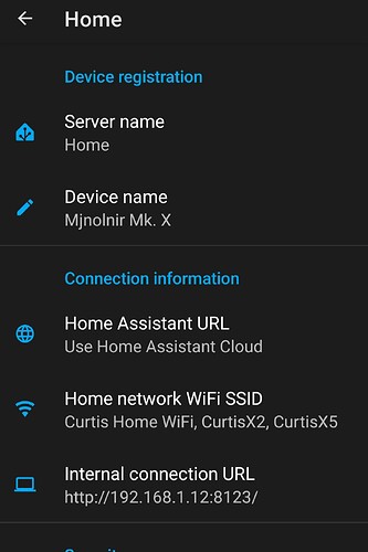

Well, let’s start with the Companion… Personality, my companion app) running on android) starts perfectly well and connects to my personal install of HA through the local network on Wifi using both it’s local ip address and local DNS (http no SSL) even if I shut off my perimeter so I’d say that one fits. Local. I connect remote through Nabu or a Vpn
Works fine.

Well, just referencing http://homeassistant.local:8123 as the server url should work.
It sure does, unless you have configured SSL on the server itself.
If you did, then you have to use https and the external domain name of the server indeed, but that’s a result of your configuration, not of the app inability to work locally.
