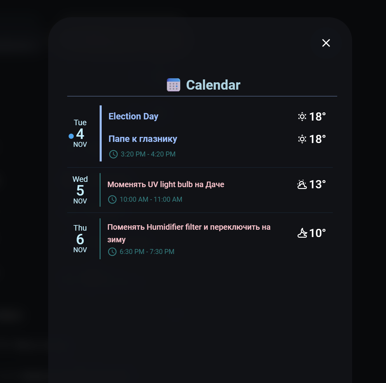

I use a bubble card with pop up for something like that
Do you have example ?
My pictures above
type: custom:bubble-card
card_type: calendar
event_action:
  tap_action:
    action: navigate
    navigation_path: "#calendars"
  double_tap_action:
    action: none
  hold_action:
    action: none
entities:
  - entity: my_calendar
    color: teal
show_progress: true
show_place: true
show_end: true
limit: 4
sub_button: []
rows: "2"
style:
  justify-content: flex-start
  flex-wrap: wrap
  font-size: 1.1em
  line-height: 1.2em
  width: 100%
tap_action:
  action: navigate
styles: |-
  ha-card {
    --bubble-main-background-color: none !important;
    #--bubble-calendar-icon-background-color: none !important;
modules:
  - icon_color
  - icon_container_color
icon_container_color:
  color: black
type: vertical-stack
cards:
  • type: custom:bubble-card
    card_type: pop-up
    hash: “#calendars
  • entities:
    • icon: “”
      accent_color: “#ff6347
    • entity: calendar.my_calendar
      color: pink
      accent_color: teal
    • entity: calendar.family
    • entity: calendar.birthdays
      color: cherry
    • entity: calendar.holidays_in_united_states
      days_to_show: 4
      compact_days_to_show: 4
      compact_events_complete_days: true
      filter_duplicates: true
      split_multiday_events: true
      title: :date: Calendar
      title_font_size: 24px
      title_color: “#baf1ff
      day_separator_width: 1px
      day_separator_color: “#03a9f430
      week_separator_width: 2px
      week_separator_color: “#03a9f480
      month_separator_width: 3px
      month_separator_color: “#03a9f4
      today_indicator: pulse
      today_indicator_size: 10px
      weekday_color: “#baf1ff
      day_color: “#baf1ff
      month_color: “#baf1ff
      show_single_allday_time: false
      time_24h: false
      time_color: teal
      time_icon_size: 18px
      remove_location_country: true
      location_color: “#baf1ff
      location_icon_size: 12px
      weather:
      entity: weather.combined
      position: event
      event:
      icon_size: 20px
      font_size: 20px
      color: white
      tap_action:
      action: expand
      refresh_on_navigate: false
      type: custom:calendar-card-pro
      weekend_font_size: 14px
      weekend_color: pink
      card_mod:
      style: |
      /* Make today’s events stand out /
      .day-table.today .event-title {
      font-size: 16px !important; /
      Larger text /
      font-weight: bold !important; /
      Bold text /
      color: var(–accent-color) !important; /
      Use theme accent color */
      /* Add subtle left border pulse animation */
      .day-table.today .event {
      border-left-width: 4px !important;
      transition: border-left-color 1s ease-in-out;
      animation: todayPulse 3s infinite alternate;
      @keyframes todayPulse {
      from { border-left-color: var(–accent-color); }
      to { border-left-color: var(–primary-color); }
      ha-card {
      –ha-card-background: none;
      ha-card .header-container h1.card-header {
      width: 100%;
      text-align: center;
      font-weight: bold;
      border-bottom: 1px solid var(–primary-color);
      float: none !important; /* Override the default float:left */
