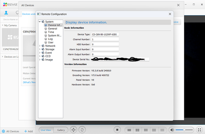

Ezviz Studio software. By making a modification to a *.ini file, you can enable advanced configuration when you restart the program.
Opening that configuration automatically enables RTSP without doing anything else.
C:\Program Files (x86)\Ezviz Studio\config\AppConfig.ini
Edit file and insert this code:
[LocalOperation]
Show=1
3)Save the file in another folder and move with admin rules
4)Open de software and go to the config camera
5)Open Adcanced config
RSTP is activated

I’m trying with 2.1.6 and 2.5.1, not appear “Remote configuration” with modified .ini
