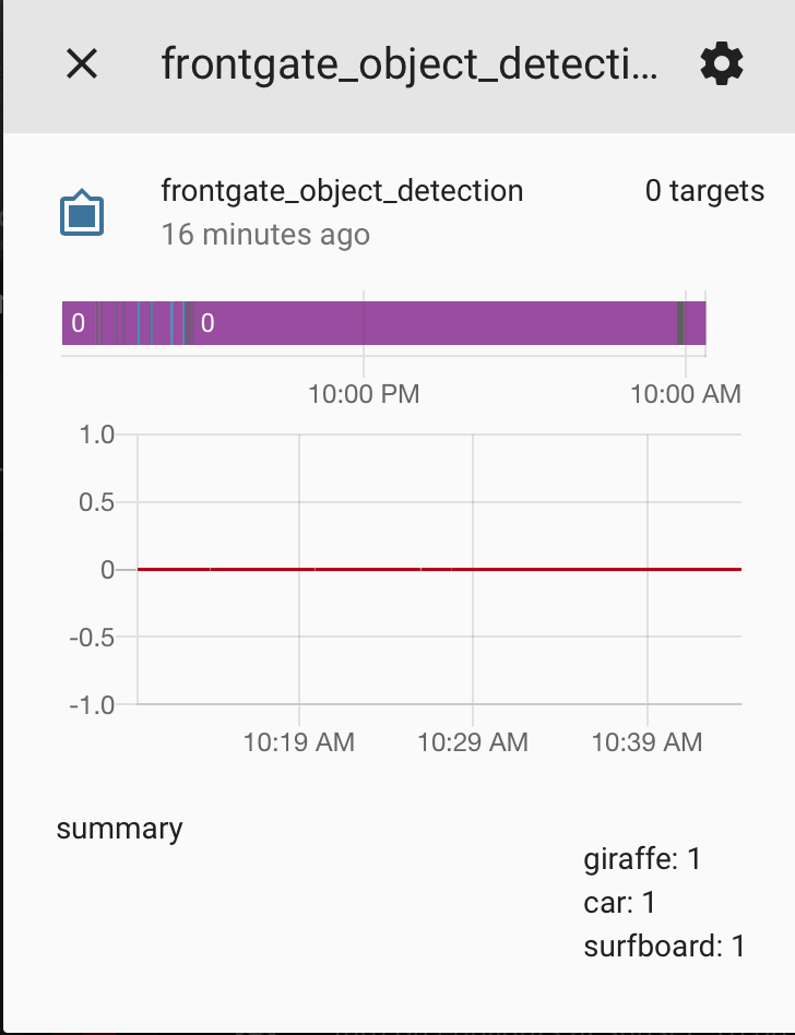

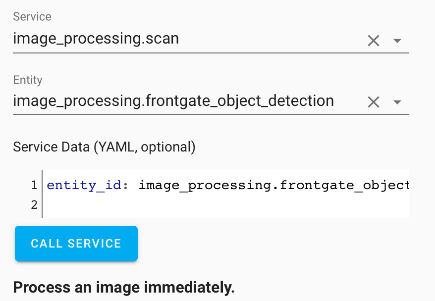

I just upgraded to the new version 3.0 and I’m having all kinds of trouble. I changed target to target(s) and read the docs and realized you removed scan_interval: also, so I got rid of that. The object loads ok, and I can only trigger it VERY sporadically. Sometimes it fires, most of the time it doesn’t which now renders my entire integration unusable. it might take 20 clicks on ā€œCall Serviceā€ to fire once. The camera works fine and the stream is stable and consistant.

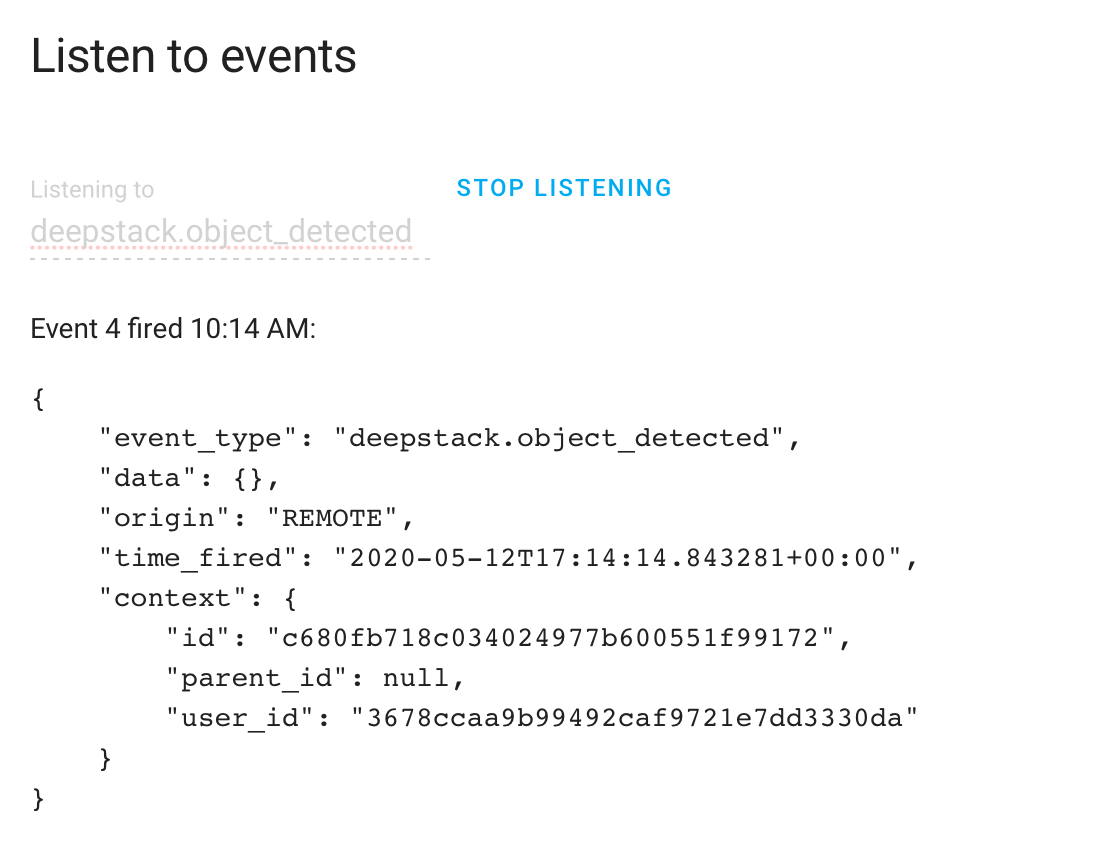

Also, you mention " use Developer tools -> EVENTS -> :Listen to events , to monitor these events". When I can get it the object to fire using the call service, there are no events listed at all, even though I can fire that event manually as often as I want:
