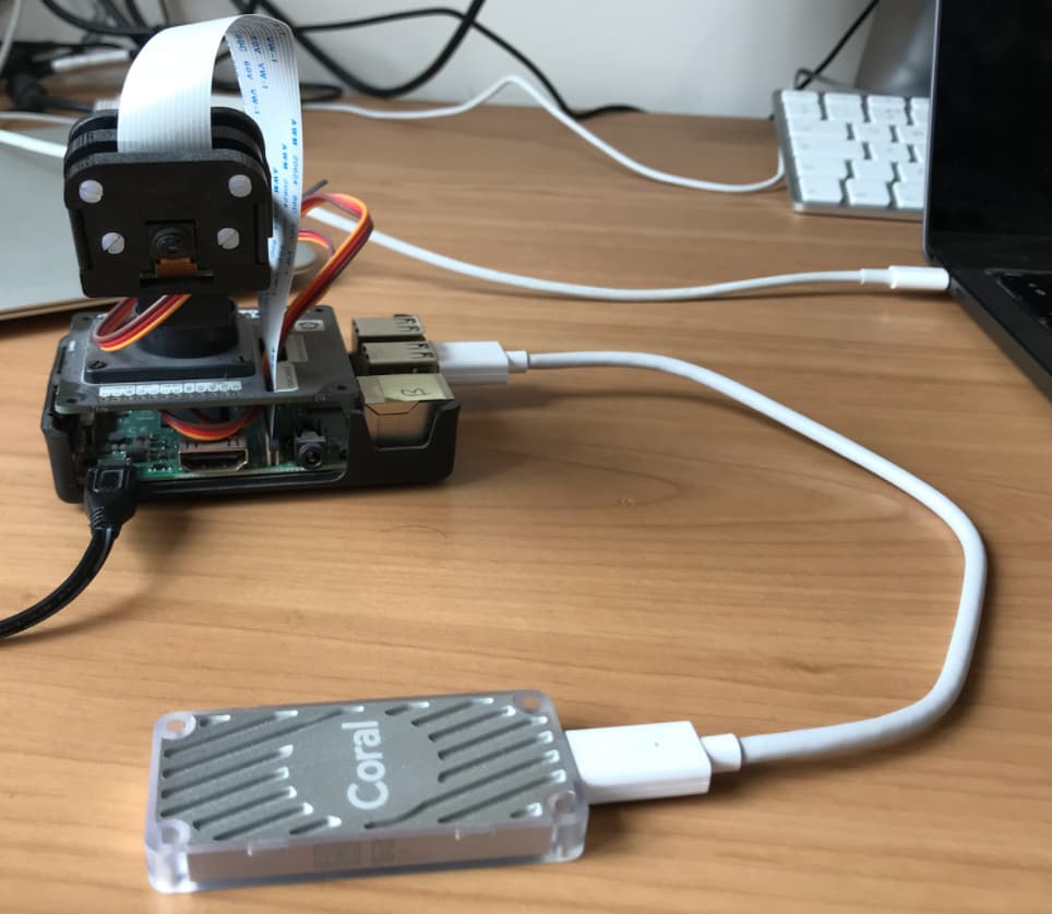

Excited to discover this addon which supports using google coral and integration with my deepstack components
