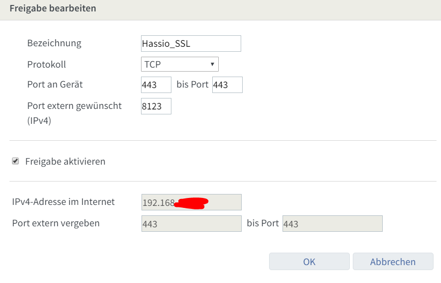

So, now I guess, the only open thing is getting it work from externally. Maybe I did something wrong with the port forwarding. It looks a little bit odd (sorry for the German).
In this post it is said that the FritzBox uses Port 443 internaly, could this create a problem?

Anyway, that pic in @hackmett’s post does not look like a port forwarding page. There is no destination port.
On some routers you need to both open the port AND forward it on separate pages. Are we sure that isn’t just the port open page?

I agree that the table looks odd. Here is a picture of the editing page, that looks more familiar.

Really hard to translate the German but looking at my own 7490 (and not wanting to change anything on it while I am at home and it is at the office!) I think you need to put 8123 in all those port numbers. Try that. Then, from outside your network, try to connect using https on port 8123

I changed the settings
And tried to connect to https://XXX.duckdns.org:8123/
Sadly it still doesn’t work.

Still it does not work. I am not sure if i set the forwading correctly. I find the menu of the Fritz confusing:

IPv4-Adresse im internet - 192.168.178.41… that is a local LAN IP address, not an internet address…

Yes, that is the IP of my RP. According to this manual, I thought that the forwarding has to be done for the RP.
