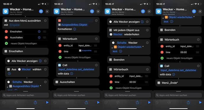

I switched from android to iOS, but I wanted to have the “next_alarm” for my light timer back. I used @WiiiLDFARMER example. But I added a choice function to use one of the created alarms and an option to disable all alarms.
It is in German too. Einschalten = Enable, Ausschalten = Disable.
In shortcuts:
Link to the Shortcut
In Automation (disable the alarm in HA):
In Home Assistant:
input_datetime:
  next_alarm:
    has_date: false
    has_time: true
  - platform: template
    sensors:
        alarm_time:
          friendly_name: "Weckzeit"
          value_template: "{{'Aus' if ( states('input_datetime.next_alarm') == '00:00:00' or states('person.admin') != 'home' ) else (state_attr('input_datetime.next_alarm','timestamp')-(60*60))| timestamp_custom('%H:%M Uhr')}}"
          icon_template: "{{'mdi:alarm-off' if ( states('input_datetime.next_alarm') == '00:00:00' or states('person.admin') != 'home' ) else 'mdi:alarm'}}"
