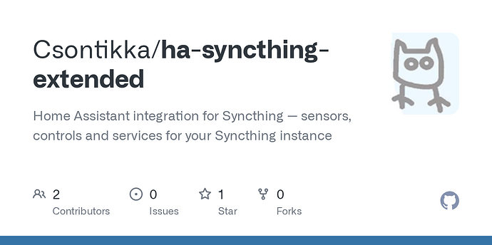

Hey,
Saw this thread and had to chime in. I ran into the same frustrations (device connectivity, last seen, folder scan times not being surfaced), so I ended up taking an extended version of the integration that covers most of what’s been asked for here.
Device sensors: connection type, address, version, last seen, uploaded/downloaded bytes. Plus binary sensors for connected and paused status.
Folder sensors: completion %, bytes needed, files needed, in-sync size, local size, pull errors, last scan, last synced file. Binary sensors for error, syncing, paused.
Also pause/resume buttons for folders and devices, scan triggers, and proper config flow with reauth (no YAML).
It’s on GitHub if anyone wants to try it:
This thread basically served as the feature list, so happy to hear feedback or more requests.
