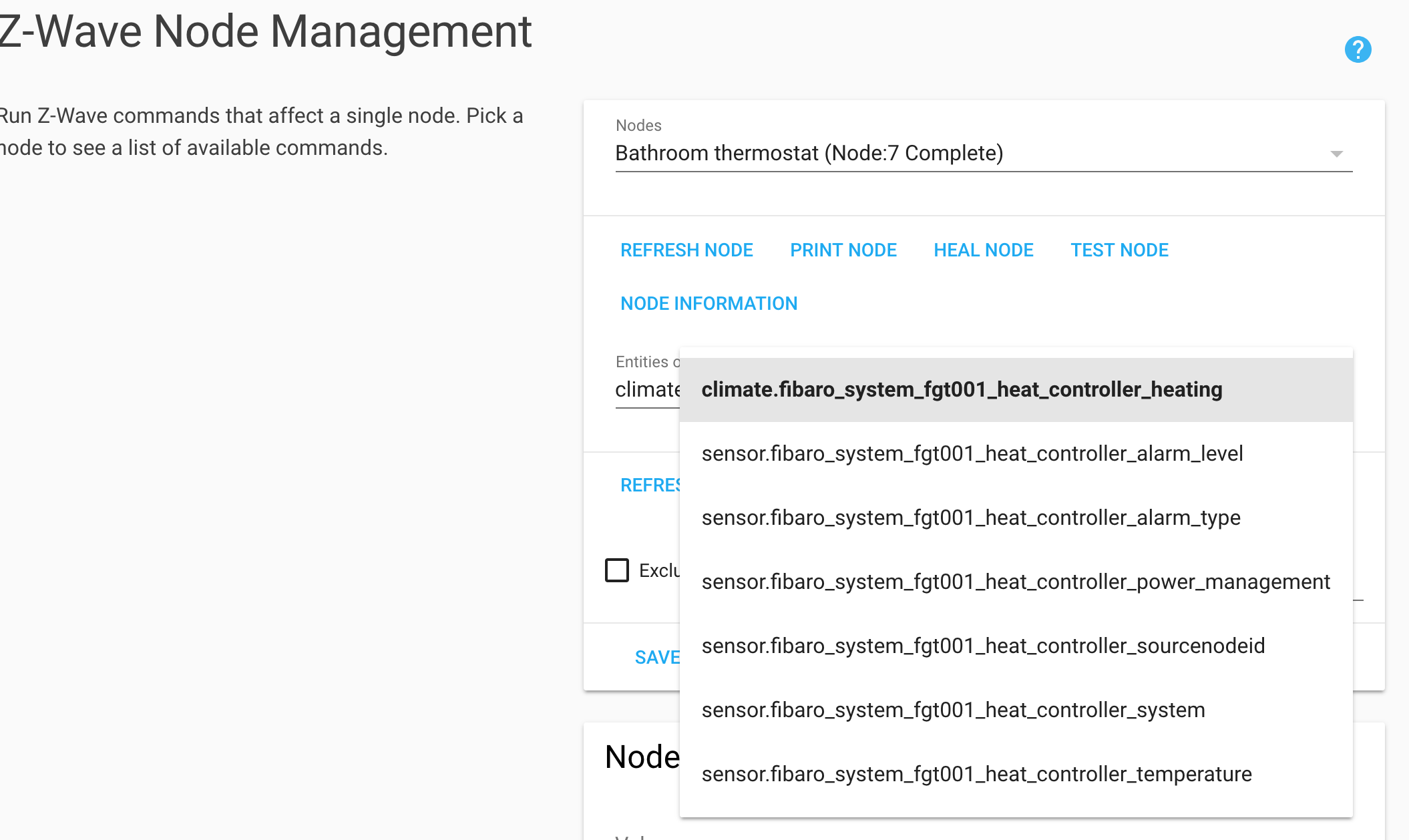

Which z-wave node entity is the heater? The only one I have that looks like a “heater” is the climate.XXX_heating that I created. But if I shouldn’t use the climate component, I’m not sure which one is the heater (I’ve got the system and temperature):
So I’m not really sure how to set a target temperature without using the climate component??
You need to update the climate entity.
action:
- data:
    entity_id: climate.fibaro_system_fgt001_heat_controller_heating
  service: zwave.refresh_entity
but you, do you have an external Fibaro temperature sensor combined with the valve?
then:
controller_heating it’s the valve
controller_system I don’t know
controller_temperature it’s the external sensor
and all three put the polling intensity at 10 (10 minutes)

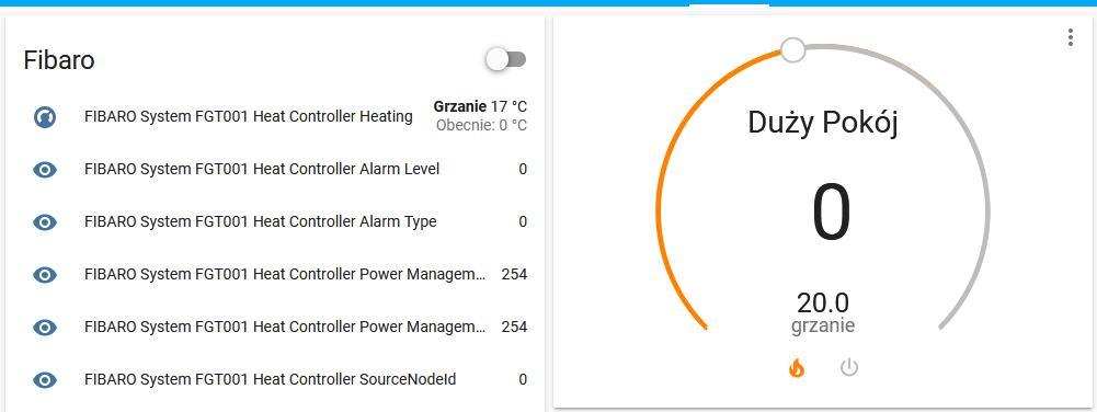

Sorry, for digging up old topic. Yesterday I installed Fibaro Heat Controller on my heater, and addedd it to HA wia Aeotec Z-Wave 5gen. Got all bunch of components from it in HA, created climate card. I can turn it on and off (I can hear valve move), and also increase and decrease temperature (also valve moving). Of course I encountered same problem with not updated card component when I do this. I put the automation in use which looks like that now, and i got notification every time i turn on/off or change temperature, but HA is not updated. Im running HA 0.99 now.

By the way, when you switch operation mode of the Fibaro’s climate entity, is it changing or returns to previous state in a second?
I can turn off or turn on and I can hear valve is closing or opening, but if HA booted on “heating” it is always “heating”. If its ON and I turn it OFF, next reboot of HA will update its status to OFF, also if I refresh it from Z-Wave manage in Hassio it is also refreshed (dont know why it is not refreshed from automation). Also when moving slider of temperature in this example from 17 to 20 it stays on 20 on climate but on fibaro it is still 17. Updating entity by hand or by HA restart will update component, but not from automation.
I think this is because you are trying to update climate. with zwave.refresh_entity. It can update only zwave..
I suppose you should use homeassistant.update_entity.
