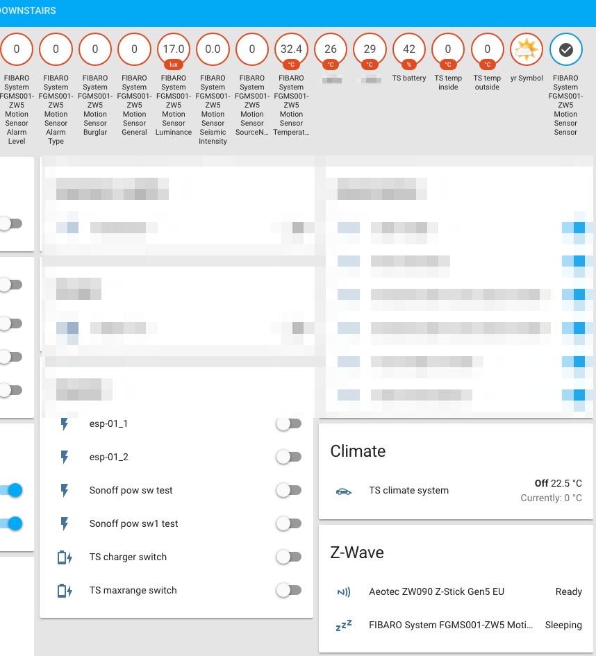

Sensors:
The following sensors were created:
A binary sensor (with the suffix
_sensor_sensor). As mentioned above, it turns on when there’s motion, tampering, or either, probably depending on the 4th and 5th association groups. It also seems more reliable when it comes to cancelation frames than the burglar sensor (see below). -
Alarm sensor (
alarm_typeandalarm_level). I’m not sure what these do and haven’t seen them turn on. Perhaps this is related to association groups 2 & 3. - SourceNodeId sensor. No idea what this does. Like the alarm sensors, it seems to always be at zero.
- General sensor. No idea what this does either. Seems to be at 255 on vibration, and 0 otherwise.
- Burglar sensor. I’ve seen it at 3 (tamper, i.e. vibration), 8 (motion), and 255 (Case open), as mentioned in the docs. If you want individual binary sensors for the different states, you can define template binary sensors that check for the relevant state. This sensor seems less reliable with cancelations (i.e. stays on for too long) than the binary sensor.
- Luminance and Temperature sensors. These are self explanatory and work as expected.
- Seismic Intensity sensor. By default the device does not report this. If you change configuration parameter 24 to the value 1, then this sensor would work as expected (scale seems to be 1 to 10).
