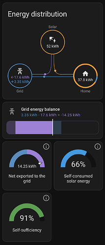

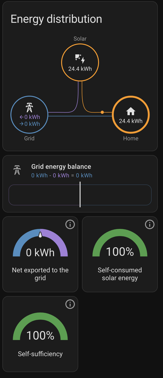

After updating the energy dashboard's electricity grid section to use these import/export values, the dashboard doesn't show any export.
Guessing I'm missing something basic again.
I've updated the blueprint description for the capital F issue, my mistake, sorry for the confusion.
As for using the blueprint en getting actual values. Can you confirm that you have a TOTAL-CONSUMPTION CT (Current transformer) installed? This will show in the HA device info page for the Envoy , or download the diagnostics file for details on what is configured.
I assume you verified there is actual data variations in sensor.envoy_482544054638_lifetime_balanced_net_energy_consumption
I do and there is actual data variations in the lifetime balanced net energy consumption. I think my last problem was just impatience :sweat_smile:

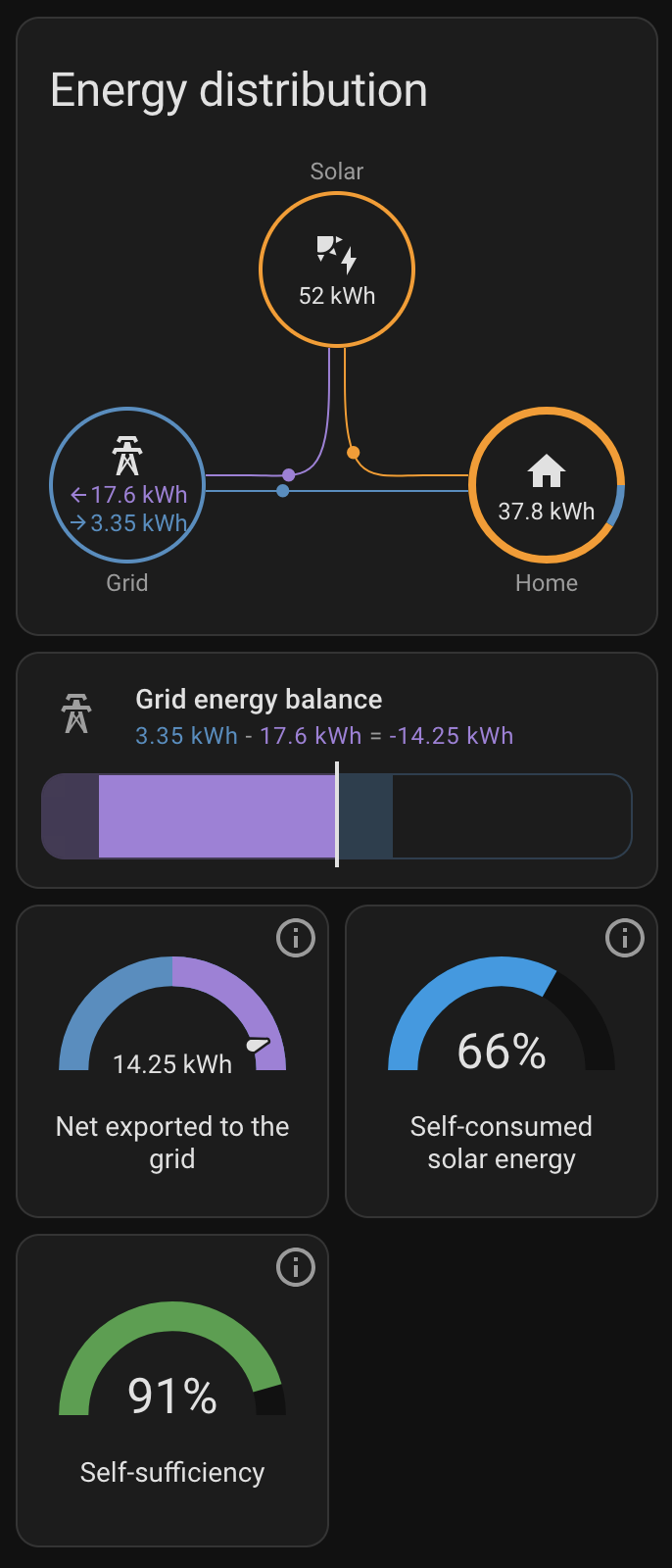

This pic after the rest of the day went on shows what I'm assuming are correct values, but I'll need to wait another day to have a full day's worth of info setup this way and then check the maths myself.
Thank you for following up and thanks to petro as well for helping me through this. Would be neat if HA was able to do this math automatically via the energy dashboard without the extra steps.
