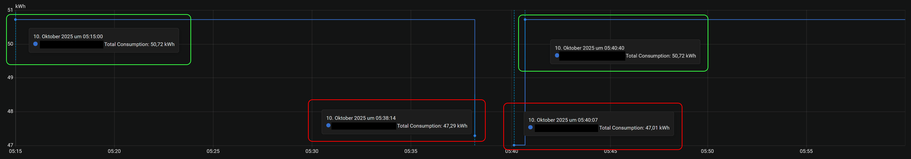

Here is a real-life example from yesterdays latest incident:
Raw
With values

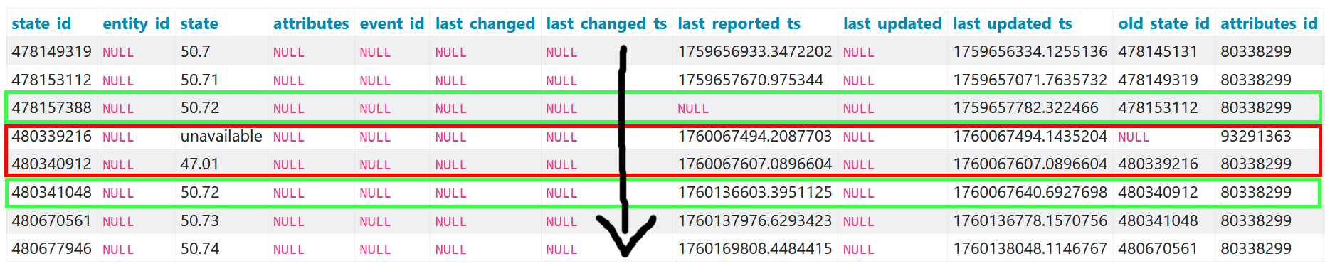

Checking the database (STATES table) via
SELECT *
FROM "states"
WHERE metadata_id=(SELECT metadata_id FROM states_meta WHERE entity_id="sensor.xyz_total_consumption")
AND state_id>=478149319 AND state_id<=480677946
ORDER BY state_id ASC;
gives

Based on the database query I don’t think so, as the availability template would help filter out the unavailable input sensor state. But my problem here is the next state 47.01 before the correct 50.72 follows next. So I think I would need to filter out the 47.01 (overall: lower values) instead of or additionally to the unavailable state.

Your problem isn’t the state transition 50 → unavailable or unavailable → 47. The problem is the transition from 47 → 50.

The problem is that when the device becomes available again it does not return directly to the previous value (50.72) . It logs some intermediate value first (47.01). The transition from 47 to 50 is seen as an almost instant production of 3kWh.

No, it first has a datapoint at 47.2. that drop from 50 is registered as production. Then it goes unavailable. Then from unavailable it goes to 47. If that difference from 47.2 is not counted by the utility meter that would be a bug. then the increase back to 50 is registered and cancels out the production. So either the problem is reduced to a 0.2 error (and I really think that would be a bug) or the 0.2 is regstered, and all is canceled out.

No matter what the state class the utility meter works like this:
50.72 → unavailable = add 0kWh
unavailable → 47.01 = add 0kWh
47.01 → 50.72 = add 3.71 kWh

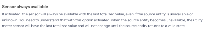

Add this to your utility meter:
sensor_always_available: true
And change the plug energy sensor state_class to total instead of total_increasing.

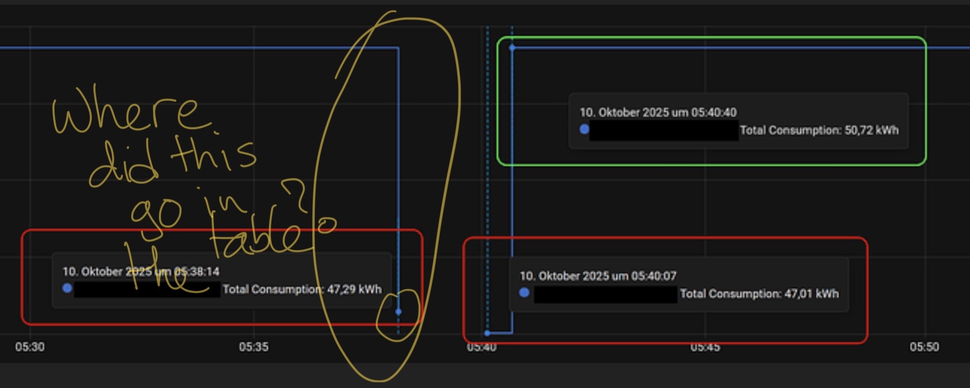

So it did not go directly to unavailable. And that was not logged.
Something is very wrong with that plug.
Could it be that that was there but got edited out by manually fixing statstics?
