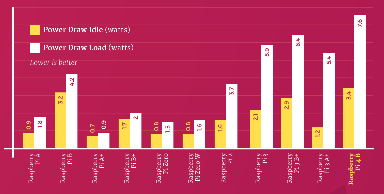

It is more than assumptions. It is based on what I have observed and tested. Thanks for your inputs though. The rPi4 has problems under load with 2A/5V and is prone to rebooting. Under load it benchmarks about the same as a compute stick which never consumes more than 7W. Likewise my mini PC is the N5000 never consumes more than 9W under stress with 2 SSDs, averaging 8W which the rPi4 easily hits with nothing attached with less than 1/4th the performance. The temperature from all the testing is also another data point. Under stress, my passively cooled N5000 never exceeds 65C. The same stress program on the rPi4 with an active cooler reaches 75C. The TDP of the intel chips are 3W for the Z and 7W for the N, the rPi’s is also 7W but power regulation on the rPi seems to be poorer causing power spikes/burst. At idle the bare rPi4 consumes ~3W, the mini PC with the SSD consumes 0.7W. Essentially the rPi consumes the same or in some situations a lot more power running much slower and generating a lot more heat, causing throttling which my mini PC never does. The rPi4 is cheaper by 25-30% when considering the case, cooling, power supply and storage to match the mini PC.
References which matches my observations:
https://www.raspberrypi.org/documentation/hardware/raspberrypi/power/README.md
https://androidpctv.com/review-beelink-s2/
And some benchmarks with links I collected when I had to make this decision, the N4100 is the same chip as the N5000, just a lower clock:
Considering the documentation states 600ma (3 Watt) this is for the whole board.
A tdp of a processor cannot be considered the whole use of a system.
That is also stated in the documentation of raspberry hdmi WiFi Bluetooth etc etc also use power.
Also the the pi 4 has more integrated in the broadcom chip (Lan) witch also contribute to a more power consuming chip.

I agree, the mini PC is also for the whole PC with wifi, ethernet and 2 SSDs… it consumes 0.6W vs ~3W for the rPi at idle. Under load they are much closer but the mini PC is 4-10x faster. The point is that the rPi4 consuming less power than the NUC under any circumstance is a myth. In general I noticed a magic number of 4. It is 4x slower at the same power or consumes 4x more power running at the same speed and the same applications than a current equivalent PC. If you look at the benchmark table, the rPi4 is really closer in performance to the atom Z8350 (although arguably still slower in various benchmarks) compute stick or board which consumes 3-4W under max load, ~4x less that the rPi4. This was in response to the power question… it’s not even close. It’s 4x lower. I did try by the way to power the rPi4 with the same POE splitter (rated for 5V 2A) and it would crash and reboot randomly even with nothing attached under various load. My mini PC running (12V 1A) never does even under stress test. (there is a linux package called stress). I am measuring power with a smart meter.
I would venture to say that if you run exactly the same programs (home assistant for example) and equivalent OS (rasbian/debian) with the equivalent RAM(4GB) and peripherals SATA SSD on the board the same generation NUC (gemini lake) will consume significantly less power than the rPi4, likely 4x less. (ie 1W vs 4W)

Pi 4B only takes 1A so 5W when it’s running.
Not quite, from the reviews link above:
The rPi4B idle eats 3.4W while the mini PC with a few more peripherals takes 0.6W.
Under load, the rPi4B uses 8W while the mini PC peaks at 10W. This corresponds to my observation as well. Under any equivalent usage case (running the same programs), the rPi consumes 4x more power than the intel equivalent. When pushed to full load, they consume about the same power but the mini PC runs ~4x faster and can do ~4x more tasks simultaneously. Notice from the review that not a single of the tested mini PCs consume more than 1W at idle. Not AMD, not the intel NUCi7.
