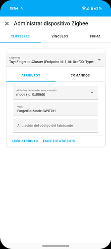

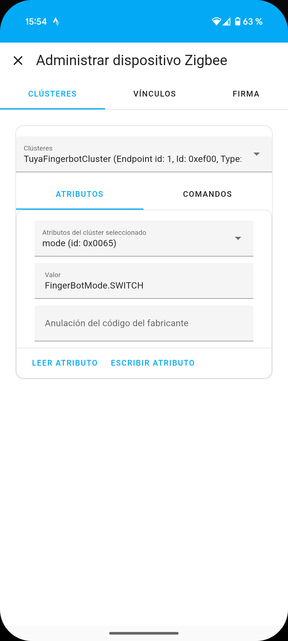

i have the same device, and you can configure it with HA.
when you are on the device zigbee page in HA, clic on the tree dot in the bottom-right of the Device Information frame and choose “Manage the zigbee device”.
In this new window stay on “Cluster” tab and choose “TuyaFingerbotCluster” in the dropdown list.
In attribut dropdown list choose “Mode” and click on “read attribute” and replace Click by Switch in the value.

My screenshot looks EXACTLY the same as Larsjo
Do I then WRITE ATTRIBUTE ?
Do I need to do anything after that ? Remove device / ReAdd device ?
As I can’t get it to work in the manner required (Push / Pull ONLY)
Sorry, got this working
FingerBotMode.SWITCH
Worked for me, thanks all
