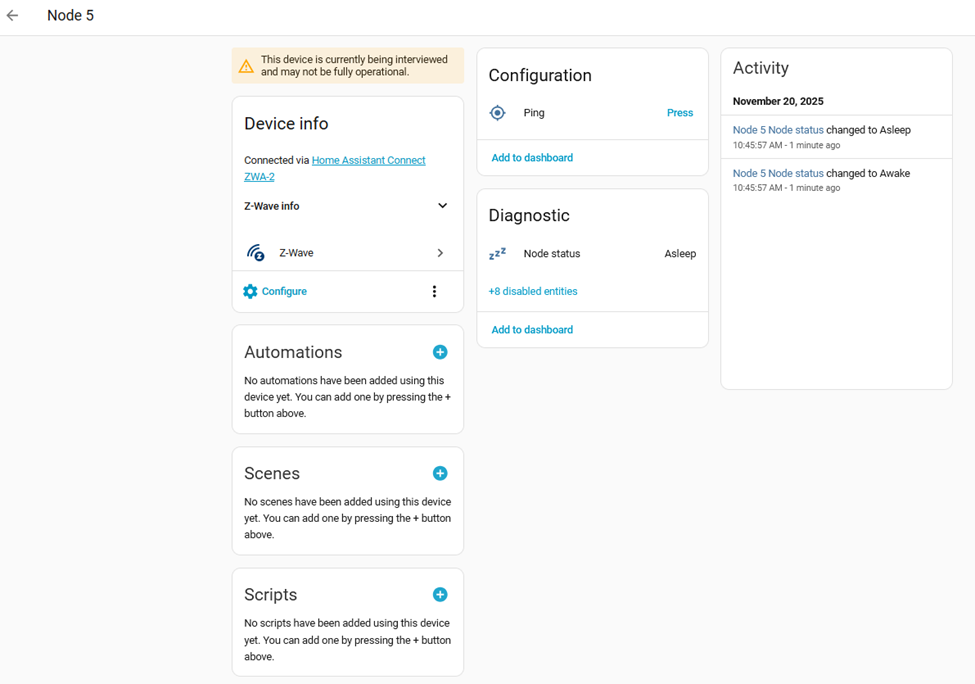

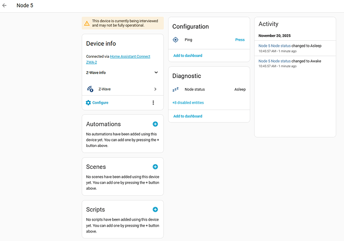

  4. Open a new Home Assistant window to view pairing status. NOTE: Node status Asleep
  1. First Alert SMCO410: Install mounting ring, then press and hold Test/Silence (8 seconds?) to start a test, Node wakes up and completes pairing:

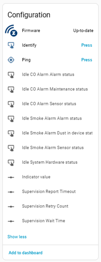

  2. BUT… the most important Configuration entities are DISABLED. All of the buttons to idle various alarm status settings are inoperative.
I have two SMCO410s operating without all of the configuration options. Suggestions on how to correct this would be much appreciated.

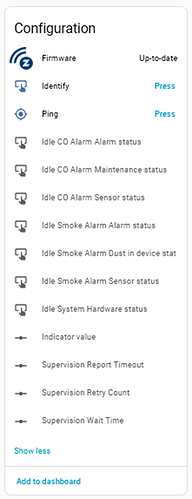

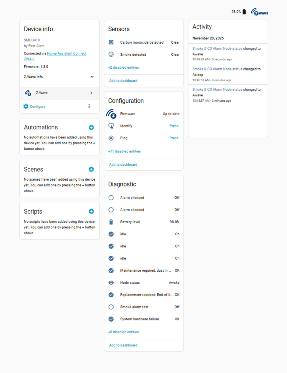

All Z-Wave device configuration entities and idle buttons are disabled by default. There’s no reason to enable the config entities for this device, if needed you can access them from the config sub-menu. I enable the “Idle Smoke Alarm Alarm status” so I can automate clearing the test alert.
That just what I’m looking for. Would you be able to give an example enabling the “Idle Smoke Alarm Alarm status” ? some direction as to how to use this page: ?? Thanks!!

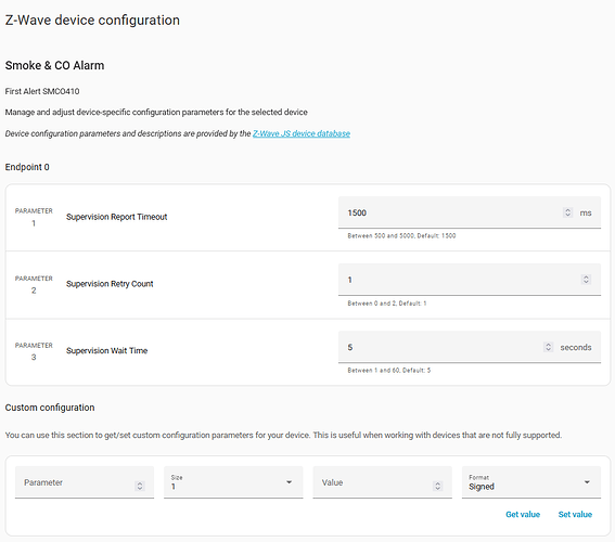

Is this the config sub-menu you are referring to?
Click on the entity → Settings → Enabled → Update
Yes. You probably don’t need to change any of those without a good reason. There’s definitely no reason to automate changes through entities (keep disabled).

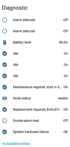

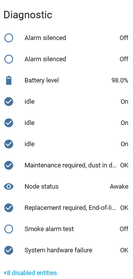

I just installed my second and last SMCO410. As a final step, I pressed to TEST button to ensure all was well. Everything seemed to work AOK, unfortunately I had to enable both Idle CO Alarm Alarm status and Idle Smoke Alarm Alarm status to get Smoke alarm test set to Off and all the proper idle status set to On.
I just use a simple automation to press the idle buttons after 20 seconds of the test sensor being on.

I just added two of these successfully. Let me summarize the process to save anyone else from reading the whole thread.
If you were patient and read this before activating the alarm by spinning it onto its base, the easiest way to add it is to go to add device in HA and scan the QR on the alarm, then spin it onto the base while HA is searching. HA will find the device without pressing any buttons on the alarm.
If you weren't patient (like me with the first of the two alarms :sweat_smile:) and already activated the alarm, don't worry. Do not bother with the QR code. If you tried adding by QR code after the alarm was activated and it didn't add properly, delete all traces of the device from HA (mine had two, one was the provisioned QR code and one was the actual device that showed up but missing attributes). Then fully reset the alarm by holding down the button until it does 3 beeps, this can take 30 seconds. Next, enter traditional pairing mode in HA (no QR code). Hold the button down until it does 2 beeps (this is also exclusion mode if you need to exclude it for whatever reason). HA should find it and ask you for the 5 digit pin on the back.
The chatter above about manually idling the test state, this is the device diagnostic "Smoke alarm test" which is only turned "on" when you physically test the alarm by holding the button down until it beeps once. Then it gets stuck on. I don't believe this interferes with the actual alarm state as seen by HA because they are different entities, but I don't know for sure. To clear it, under configuration, enable the entity "Idle Smoke Alarm Alarm status". This gives you a button to clear the test state, you just have to remember to press it each time after you test the alarm. Or if you want to automate that, scroll up!
