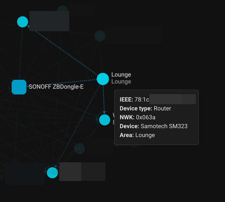

Thanks for sharing this. Do you know if this dimmer can act as a Zigbee router (if the neutral is connected)?

Looks like it is a router.
I have them connected via ZHA with a neutral wired in.
It’s offline at the moment as I have just set them up in the house then fitted them in a new build garden room that hasn’t got zigbee coverage yet.

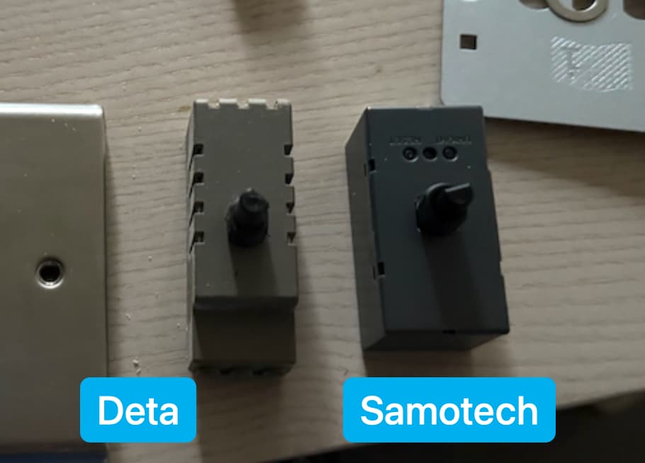

My biggest challenge now is what @triblondon here calls out. Since it’s wider than usual dimmer module, I’m struggling to find a faceplate that’d match my exisitng ones (Deta Slimline Décor).

I think I’ll order a 2-gang to have it to hand and try to visit a few hardware shops to see if there’s a plate that’d match the spacing of those still.

Just incase this helps anyone, I’ve recently used the varilight matrix dimmer plates for ours, only tried the single gang, works well and quite cheap as doesn’t include any dimmers, just the base plate, screwless cover and the dimmer knob. You can easily drill 3 holes in the plate using the original as a template so you just pry the screw less cover off to use the buttons if you need to.
