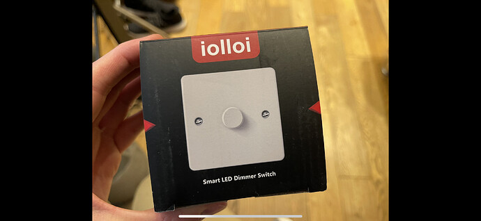

Comes in a simple cardboard box:
Zero stars for design effort but it looks credibly like a basic dimmer switch:
