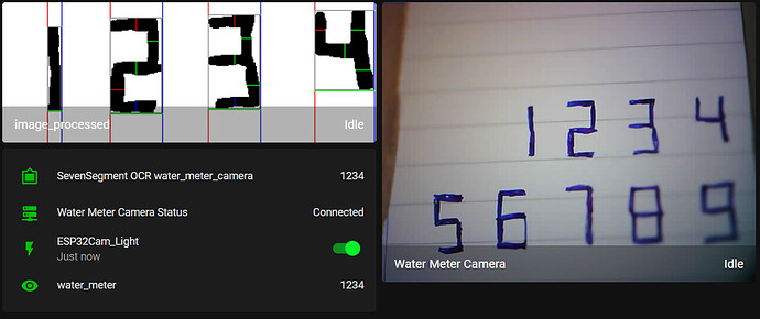

A picture might explain better.
With LED light on:
With LED light off:
I would like for “water_meter” to retain ‘1234’ as the previously stored value.
