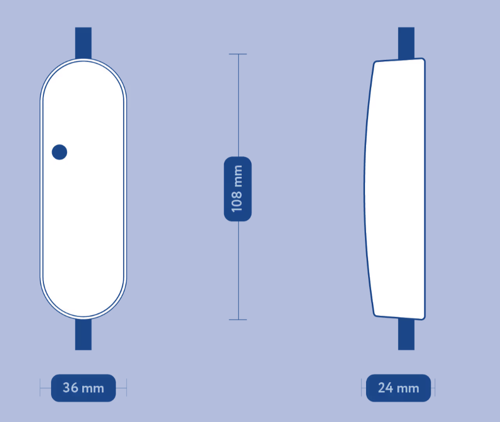

There is a very unique Frient devices, which I have seen at no other vendor: The frient Smart Cable 2, a Zigbee power device with measuring. The special is, that is not just plug, you can put right insight a cable and wiring it to the power cable. Cost’s ~42€.
(Picture taken from Smart Cable 2)

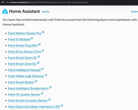

This device isn’t on the list of supported devices, on the announcement.
If the devices that are listed as compatible don’t even work well, what can we expect from one that isn’t listed at all? :thinking:
