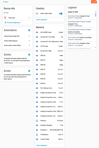

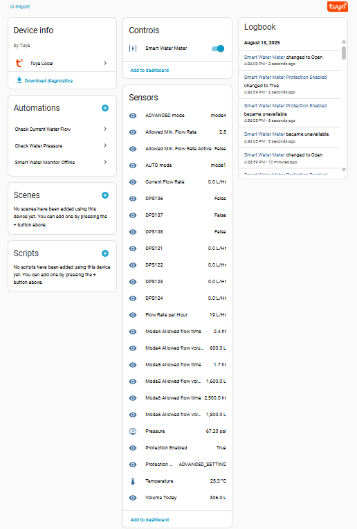

And diagnostics shows the following potential IDs
“data”: {
“name”: “Smart Water Meter”,
“type”: “frizzlife_lp365p_watermonitorandshutdoff”,
“device_id”: “REDACTED”,
“device_cid”: “”,
“local_key”: “REDACTED”,
“host”: “REDACTED”,
“protocol_version”: 3.5,
“tinytuya_version”: “1.17.2”,
“api_version_set”: 3.5,
“api_version_used”: 3.5,
“api_working”: true,
“status”: {},
“cached_state”: {
“updated_at”: 1755475510.7056916,
“1”: true,
“12”: 243,
“15”: 675,
“20”: “c”,
“24”: 0,
“101”: true,
“102”: “metric_unit”,
“103”: 4300,
“104”: 58,
“105”: 0,
“106”: false,
“107”: false,
“108”: false,
“109”: “ADVANCED_SETTING”,
“110”: “mode1”,
“111”: “mode4”,
“112”: 4,
“113”: 17,
“114”: 25,
“115”: “5”,
“116”: “16”,
“117”: “18”,
“118”: false,
“119”: “0”,
“120”: false,
“121”: 0,
“122”: 0,
“123”: 0,
“124”: 0,
“125”: “test_end”,
“127”: 300

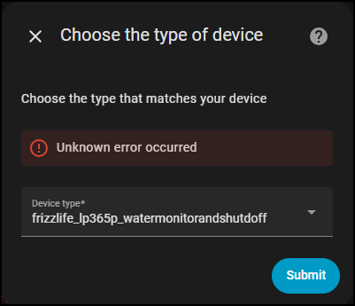

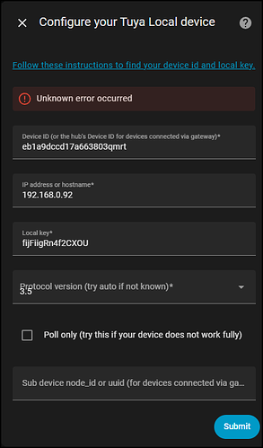

Thanks for your help, So I got one step ahead. I stripped the yaml to following but when I choose device type it fails to add.

The device shown in your image is different.
I assumed the device ID was LP365-P specific – does your device have the pressure sensor? However, if you confirm you have an LP365-P too, then the device ID must be is unit specific and you’ll need to modify the file.
Change the products: - id value in the file to match the device ID shown on your image.
And then try again.
Also, your image doesn’t show an error - can you let me know what it is?
got it, I changed the device id. My Valve is LP365 ie without pressure sensor, still getting unknown error while trying to configure :frowning:

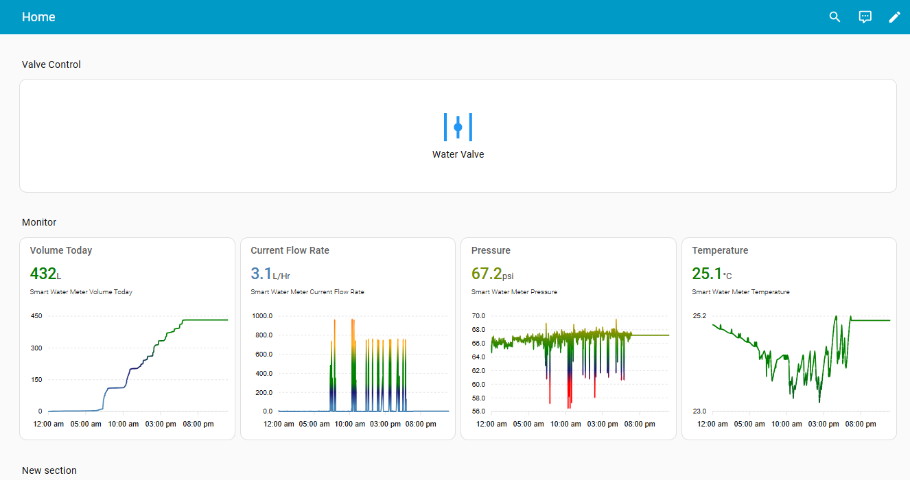

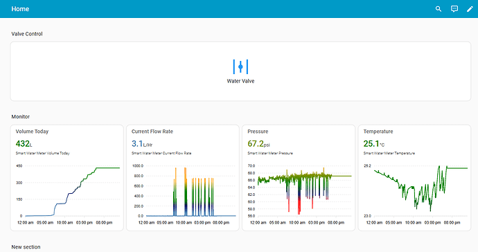

Also, taking advantage of this reply: here’s an image of my status page using HA statistics. This uses apexcharts and the experimental color_threshold:

You need to add ApexCharts Card through HACS.
Then create a new dashboard and add the following yaml code:
[Optionally you can use the visual editor to add the ApexCharts Cards.]
[You will need to remove the pressure sensor for your device and go to column_span 3 instead of 4, and you will need to adjust the thresholds for your imperial/US unit values.]
GRADIENT FIX: I just updated my version of ApexCharts and the new version of ApexCharts has a defect where the gradient does not always match the values provided. The fix is to add: “fill_raw: last” to each chart definition (i.e. just before the "color_threshold: value/color mapping).
I updated the info below to include this fix.
views:
  - title: Home
    sections:
      - type: grid
        cards:
          - type: heading
            heading: Valve Control
            heading_style: title
            grid_options:
              columns: full
              rows: 1
          - show_name: true
            show_icon: true
            type: button
            entity: valve.smart_water_meter
            tap_action:
              action: more-info
            grid_options:
              columns: 36
              rows: 2
          - type: entities
            entities:
              - entity: switch.smart_water_meter_protection_enabled
              - entity: switch.smart_water_meter_allowed_min_flow_rate_active
                name: Allowed Min. Flow Rate Active
        column_span: 4
      - type: grid
        cards:
          - type: heading
            heading: Monitor
          - type: custom:apexcharts-card
            experimental:
              color_threshold: true
            graph_span: 1d
            span:
              start: day
            header:
              show: true
              title: Volume Today
              show_states: true
              colorize_states: true
            series:
              - entity: sensor.smart_water_meter_volume_today
                stroke_width: 2
                curve: smooth
                show:
                  header_color_threshold: true
                fill_raw: last
                color_threshold:
                  - value: 60
                    color: steelblue
                  - value: 200
                    color: midnightblue
                  - value: 350
                    color: green
                  - value: 450
                    color: green
                  - value: 500
                    color: orange
                  - value: 550
                    color: orangered
                  - value: 600
                    color: red
            experimental:
            graph_span: 1d
            header:
              show: true
              title: Current Flow Rate
              show_states: true
            series:
              - entity: sensor.smart_water_meter_current_flow_rate
                stroke_width: 2
                curve: smooth
                show:
                fill_raw: last
                color_threshold:
                  - value: 60
                    color: steelblue
                  - value: 200
                    color: midnightblue
                  - value: 300
                    color: green
                  - value: 500
                    color: green
                  - value: 700
                    color: orange
                  - value: 1200
                    color: orangered
                  - value: 1400
                    color: red
            experimental:
            graph_span: 1d
            header:
              show: true
              title: Pressure
              show_states: true
            series:
              - entity: sensor.smart_water_monitor_pressure
                stroke_width: 2
                curve: smooth
                show:
                fill_raw: last
                color_threshold:
                  - value: 60
                    color: red
                  - value: 62
                    color: midnightblue
                  - value: 65
                    color: green
                  - value: 70
                    color: orange
                  - value: 75
                    color: orangered
                  - value: 80
                    color: red
            experimental:
            graph_span: 1d
            header:
              show: true
              title: Temperature
              show_states: true
            series:
              - entity: sensor.smart_water_monitor_temperature
                stroke_width: 2
                curve: smooth
                show:
                fill_raw: last
                color_threshold:
                  - value: 0
                    color: steelblue
                  - value: 22
                    color: midnightblue
                  - value: 24
                    color: green
                  - value: 25
                    color: green
                  - value: 27
                    color: orange
                  - value: 30
                    color: orangered
                  - value: 35
                    color: red
        column_span: 4
